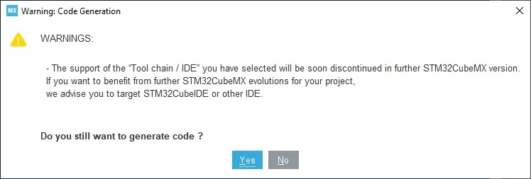

Hello
Version 6.4.0 (and maybe some versions before) introduces an ugly dialog box when generating code. This dialog box breaks command line generation because it needs
somebody to click.
Can it be replaced by a warning in the logs?
Thanks

Hello @Julien D_Oevillers​ ,
Thanks for your feedback,
The warning message shows up only when the user choose TrueStudio, SW4STM32 and GPDSC, it guides the user to change the IDE simply because in the near future these IDEs will no longer be supported with the upcoming CubeMX versions. When this happen it will no longer be possible to migrate an old .ioc file and use it with a new version.
This is the best way to inform the user about the upcoming change because it insists on the information and most importantly it is visible.
Thanks for your suggestion and I hope by this reply I answer your question.
