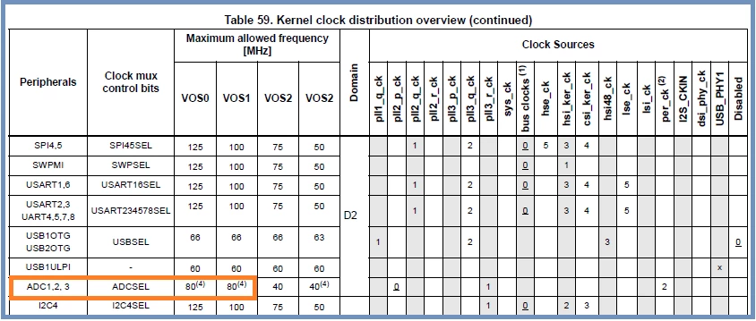

CubeMX 6.2 + HAL H7 1.9 limits the ADC clock source to 80MHz in the Clock Configuration tab
The max ADC clock is 50MHz but the source can be divided by up to 256 so there is no need to limit the source frequency

Hi @Mikhail Z​ ,
Actually, the maximum ADC frequency depends from the voltage scale value, and according to RM, the Max value cannot exceed the 80Mhz.
In fact, when the Power regulator voltage scale is set to 0 or 1, the Max ADC freq equal to 80MHz, in case when the Power regulator voltage scale is set to 2 or 3, its equal to 40 MHz (for more details, please refer to the Table 59 in the RM).

Hello @Mikhail Z​
Could you please specify the part number that you are using?
Thanks, Khouloud
Mar 3, 2021 5:48 PM UTC
H743ZI​
