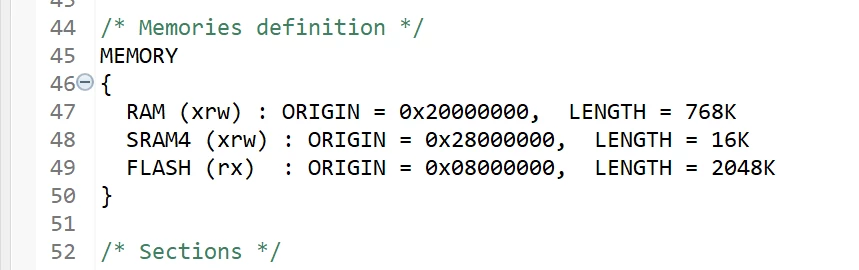

No such issues here when starting a new project.
Please include the IOC you are having trouble with.
Looks like your linker file has been manually modified. The linker file isn't regenerated when you click "Generate Code" unless it's missing.

@TDK Not sure what you mean. CubeMX absolutely regenerates the linker script with user-provided application regions. Notice:
/*start of MX regions Auto-generated By STM32CubeMX*/
We have isolated and reproduced this issue.
The problem is when regenerating the ld file. We took these steps
1. New ioc without any code generated (attached)
2. Generate code
3. Check .ld file, no issue looks good.
4. Generate code again
5. Corrupted .ld file.
6. Manually delete the .ld file in the project directory
7. Generate code again
8. Check newly generated .ld file, looks good again.
Please confirm issue replication.
In summary, first generation of a new file:
/* Specify the memory areas */
MEMORY
RAM (rwx) : ORIGIN = 0x20000000, LENGTH = 768K
FLASH (rx) : ORIGIN = 0x08000000, LENGTH = 2048K
RAMBK (rw) : ORIGIN = 0x40036400, LENGTH = 2K
SRAM4 (rwx) : ORIGIN = 0x28000000, LENGTH = 16K
/*end of MX regions*/
Every subsequent regeneration of the same file with no changes then shows this:
MEMORY
RAMBK (rw) : ORIGIN = 0x20000000, LENGTH = 768K
SRAM4 (rwx) : ORIGIN = 0x20000000, LENGTH = 768K
