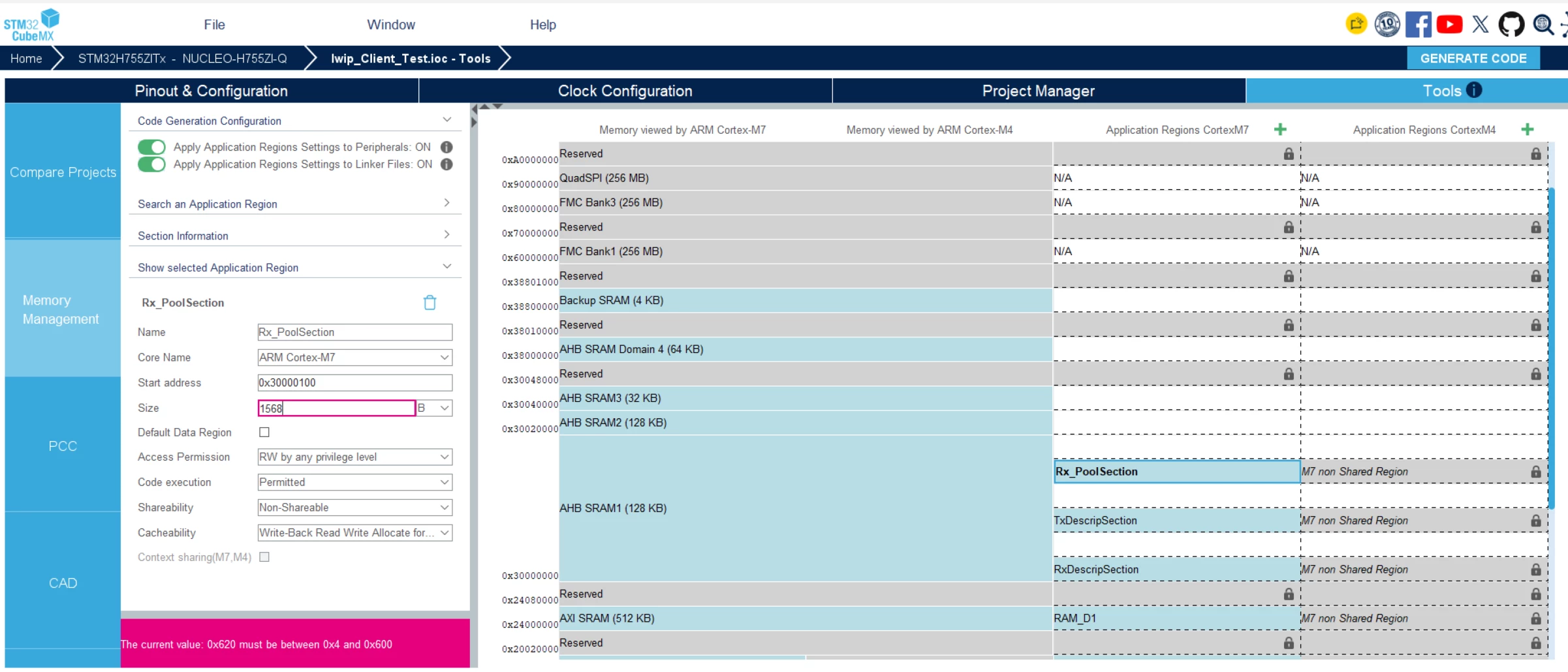

CubeMX 6.16.0 Memory Management Tool: Rx_PoolSection size vs Eth "Rx Buffers Length"?
CubeMX 6.16.0's "Memory Management" Tool assumes Rx_PoolSection size to coincide with the Eth "Rx Buffers Length" - is that correct?
I used CubeMX 6.16.0 to create a project for an STM32 H755ZI-Q.
Then I opted to use the Tools -> "Memory Management" tool and afterwards enabled the ETH [ethernet] component. This automatically generated the required sections in the "Memory Management" tool. Great.
Then I enabled LwIP [with RTOS and CMSIS v2] and generated code.
Compiling this code worked - linking however did not. It told me the contents of Rx_PoolSection were too big, i.e. the section too small:
EBoxNG3_CM7.elf section `.Rx_PoolSection' will not fit in region `Rx_PoolSection'
region `Rx_PoolSection' overflowed by 225668
The buffer for the RX_POOL is declared in CM7\LWIP\Target\ethernetif.c:98:
#define ETH_RX_BUFFER_CNT 12U
LWIP_MEMPOOL_DECLARE(RX_POOL, ETH_RX_BUFFER_CNT, sizeof(RxBuff_t), "Zero-copy RX PBUF pool");
with
__attribute__((section(".Rx_PoolSection"))) extern u8_t memp_memory_RX_POOL_base[];
residing in the Rx_PoolSection.
Thus for ETH_RX_BUFFER_CNT greater than 1 this will not work!
My solution was to increase the Rx_PoolSection Size in the Memory Management tool to be able to accomodate all 12 buffers [(1536 + 4) * 12 bytes = 18480 bytes]. But then CubeMx assumes ETH "Rx Buffers Length" to also be this big [and correctly shows an error in the GUI]. This again leads to a section overflow.
So as a second step I had to manually adapt the following to lines of code:
- CM7\LWIP\Target\lwipopts.h:51
#define ETH_RX_BUFFER_SIZE 1536
- CM7\LWIP\Target\ethernetif.c:234:
heth.Init.RxBuffLen = 1536;
The actual problem to me seems to be that the Memory Management assumes the Rx Buffers Length to be the same as the Rx_PoolSection's size.
Can anyone confirm this observation?
Or tell me that I did something wrong and instruct me as to the correct way?
Thanks in advance

Ghofrane GSOURI
Hello @JohannesWilde
Please share your .ioc file so I can review your STM32CubeMX configuration and better understand the situation you are facing.
THX
Ghofrane
Hi @Ghofrane GSOURI ,
I created a minimal example - where I first enabled the Memory Management, then ETH and LwIP for an STM32H755ZI.
Best regards
Johannes
A further note regarding an only marginally connected topic - if I should create a separate ticket, please let me know:
1. When using the Memory Management tool, then I am unable to en-/disable the "CPU ICache" and "CPU DCache" in System Core -> Coretex_M7 -> Cortex Interface Settings.
Disabling the Management Tool, manually en-/disabling the CPU caching options and afterwards re-enabling the Management Tool seems to work.
2. Also, when moving the RX_PoolSection, TxDescripSection, RxDescripSection to 0x30040000, no MPU region configuration is added for that region. And I am unable to manually add a configuration under System Core -> Coretex_M7 -> Cortex Memory Protection Unit Region x Settings.
Disabling the Management Tool, manually adding the MPU region settings and afterwards re-enabling the Management Tool deletes the manually added region.
Is there currently a work-flow where the Memory Management tool can be used and those settings configured via CubeMX 6.16.0?

Ghofrane GSOURI
1-  Actually, after moving the "Rx_PoolSection" region to address 0x30040100 and the "RxDescripSection" region to 0x30040000
CubeMX successfully reserved two MPU regions, as shown in the following screenshot.
2- Regarding the missing "s" in the section names, ticket 225186 has been escalated to the dedicated team for resolution.
THX
Ghofrane
