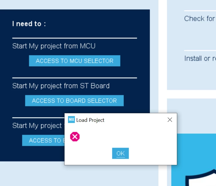

CubeMX 6.1.1 Fails to load project.
I am having a problem with CubeMX failing to load a project and not giving any description of what the error is. (See image)0693W000007ZCzEQAW.pngI started the exe using java to get more insight and I get this error
2021-02-23 10:57:51,490 [ERROR] ThirdPartyModel:1012 -
2021-02-23 10:57:51,492 [FATAL] ProjectFactory:378 - Exception caught
java.lang.NullPointerException
 at com.st.microxplorer.plugins.thirdparty.ThirdPartyIpManager.setIpMode(ThirdPartyIpManager.java:733)

I have no problem loading any other project file. Also tested it on another machine and I get the same problem.
Any input would be greatly appreciated!

Feb 23, 2021 11:56 AM UTC
Hello @SKILA​
Thanks for your feedback,
Could you please share your ioc file to check the problem from my side?
Khouloud

Hi @SKILA​ ,
You're right, I have reproduced the same issue using your ioc file (thanks for your help by sharing your project) and it will be fixed.
Always welcome, Khouloud

Hello @SKILA​
Sorry for the delay, Issue is fixed and I can load your project now, could you please check with the latest CubeMX version (it's available on site ) ?

Hello @Khouloud ZEMMELI​ ,
I have now installed v6.20 but unfortunately, I still get the same empty error message :(

Hello @SKILA (Community Member)​
I have made some changes to your project, please load the latest CubeAI pack (5.2.0) then re-configure it through CubeMX.
Please tell me if you still face a problem during the load of the ioc. (I have sent you your ioc file in message)

Khouloud ZEMMELIBest answer
Mar 3, 2021 9:17 AM UTC
Hi @SKILA​ ,
I'll share with our customers on community the steps that solved your problem:
1-Install the CubeMX 6.2.0 from site
2-Go to C:\Users\..\STM32Cube\Repository\Packs\STMicroelectronics on your PC
3-Delete the X-Cube-AI pack
Open CubeMX 6.2.0 version
4-Click on Manage Embedded software package under Help
5-Install X-Cube-AI pack VERSION 5.2.0 (latest one)
6-Load your project / double click on .ioc and merge your X-Cube-AI pack used on your ioc file to 5.2.0 version : Click on Software Packs + Click on merge icon beside the pack
Thanks for your contribution, Khouloud
