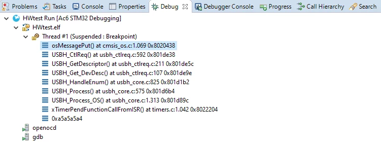

CubeMX 5.6.1 USB HOST mass storage driver hangs on startup with usb memory plugged in.
Since updating to CubeMX 5.6.1, my software won't start when there's a USB memory drive plugged into my system. It gets stuck , which is resolved by removing the USB device and plugging it back in.
I'm using STM32F756BGTx with FreeRTOS.
I think i pinpointed the problem.
Sincde CubeMX 5.6.1 the function USBH_CtlReq() contains a seccond occurence of a call to (void)osMessagePut(). I commented it out in the code fragment below.
I noticed the message sent there, results in call to USBH_CtlReq(), which results in sending the same message again, creating an endless loop.
Commenting out the second occurence off (void)osMessagePut() got my system working again.
