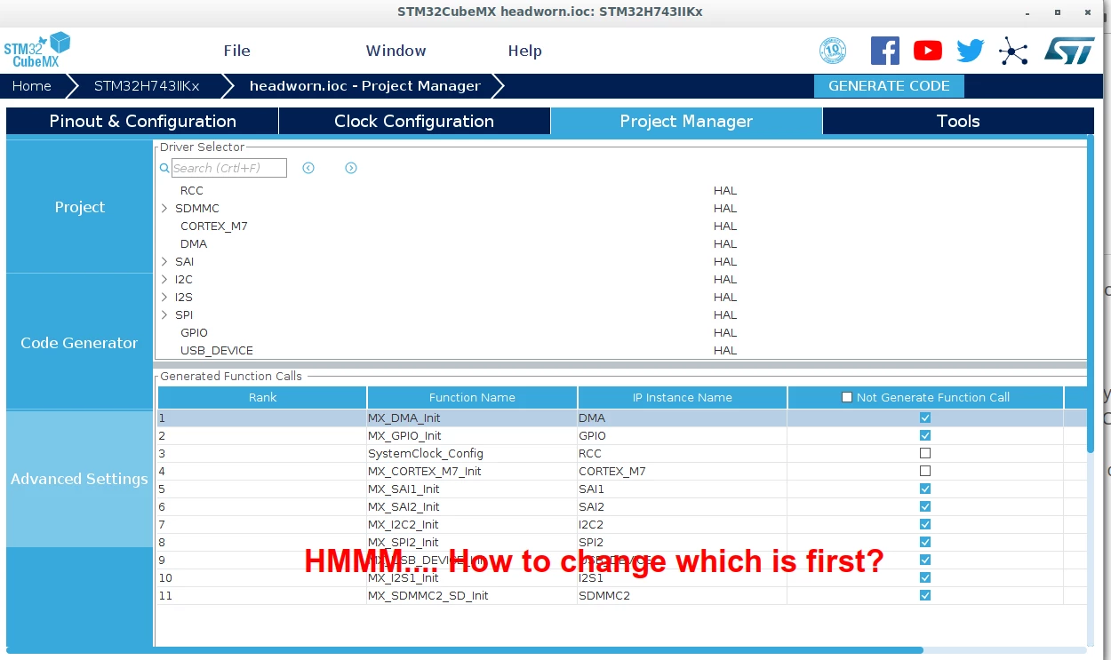

The latest version (5.4.0) of CubeMX (and who knows... maybe every version before) generates DMA initialization code out of order, and it's kind of hard to diagnose until you single step through all the HAL code.
I am using an STM32H743 and setting up circular DMA for the SAI port.
The code generated in main.c looks like this:
 MX_GPIO_Init();
 MX_SAI1_Init();
 MX_SAI2_Init();
 MX_I2C2_Init();
 MX_SPI2_Init();
 MX_USB_DEVICE_Init();
 MX_I2S1_Init();
 MX_SDMMC2_SD_Init();
 MX_DMA_Init();
The DMA for the SAI ports gets configured in MX_SAI1_Init() and MX_SAI2_Init(). Unfortunately, since MX_DMA_Init() is called AFTER the MX_SAIx_Init(), none of the SAI DMA settings get configured right, and it just doesn't work, and you spend a day or two debugging the CubeMX code. Ugh.
So, the solution is to go to Project Manager->Advanced Settings, and disable the init calls by clicking 'NOT Generate Function Call' for all the init functions, and create your own function that calls them in the right order, like this:

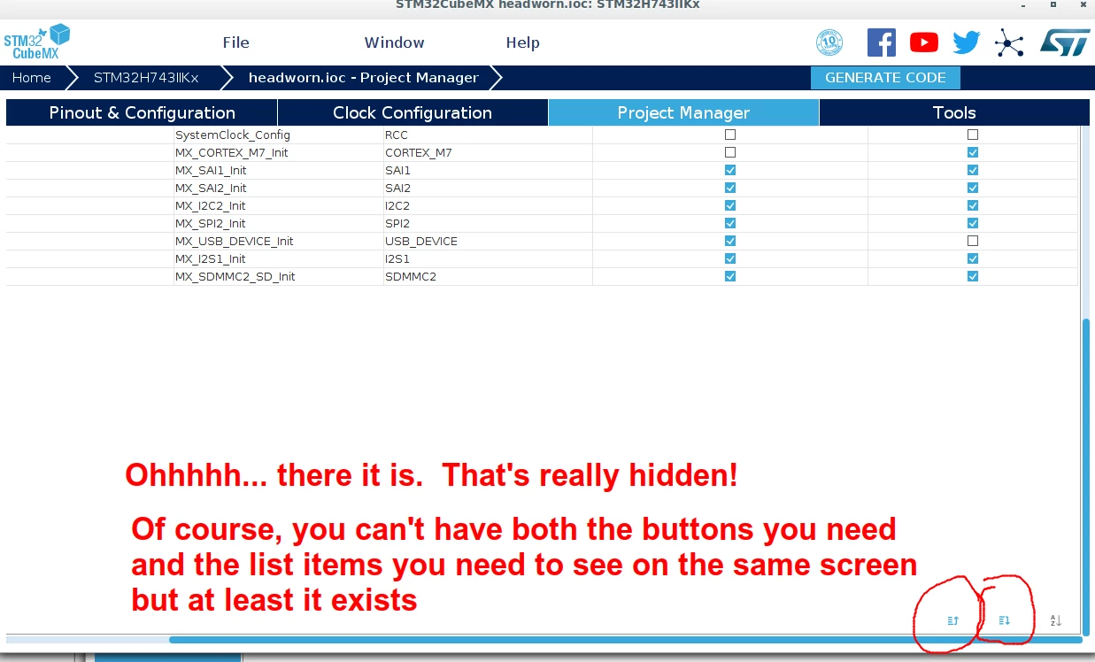

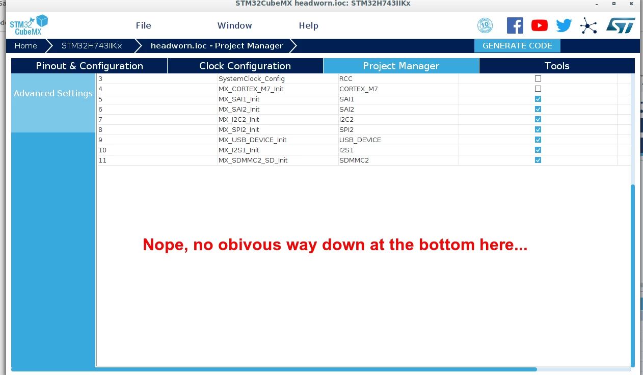

Ah! I found the secret, magic buttons that allow you to re-order the functions calls.
First of all, the tool should always put DMA first so that the generated code can work. However, you can, if you like, change the order of function calls by doing some magic-difficult-scrolling, finding the completely hidden buttons, and changing the ranking like this:
Maybe scroll down?
Oh wait... is that another, nearly invisible, scrollbar to scroll left and right? What about that?
