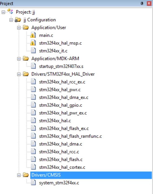

When i try to generate basic code for my STM32F429-DISCO board, CubeMX 4.6 software not generate any main.c file sometimes msp.c not be generated too !
My toolchain is: Keil MDK5.13 - new update
Is it because my toolchain uncompatible with cubemx4.6 . HELP Please ?

  Fixed my problem 3 days of system check . in Win8 most of antivirus programs deletes generated files assume that files as threat. Just disable the anti-virus program solves the problem
