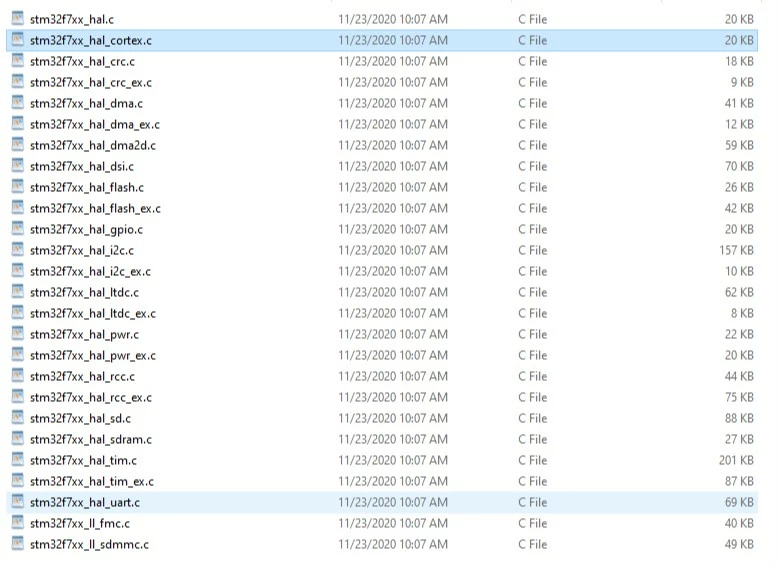

Attached is a CubeMX 4.26.0 project file (.IOC) with custom settings for the SDMMC1 interface (SDMMC1 hardware control ENABLED, among many other things). Yet when I generate code, for an Atollic project (or any kind of other project), and look at the HAL_SD_Init_Card() function in "Drivers\STM32F7xx_HAL_Driver\Src\stm32f7xx_hal_sd.c" I see SDMMC_HARDWARE_FLOW_CONTROL_DISABLE... As a matter of fact, none of my custom interface configurations are in any of the HAL files... It looks like all the files are unmodified, just copied from the CubeMX repository (modified data is over 2 weeks ago for every file)...
Please help, I'm ripping my hair out over this...

Most HAL driver files (such as stm32f7xx_hal_sd.c) don't change based on your configuration. Initialization functions in main() and in stm32f7xx_hal_msp.c will change.
SD cards are all brought up in the same configuration. Not sure what this particular bit does, but my guess is HAL doesn't support it, or doesn't support it well.

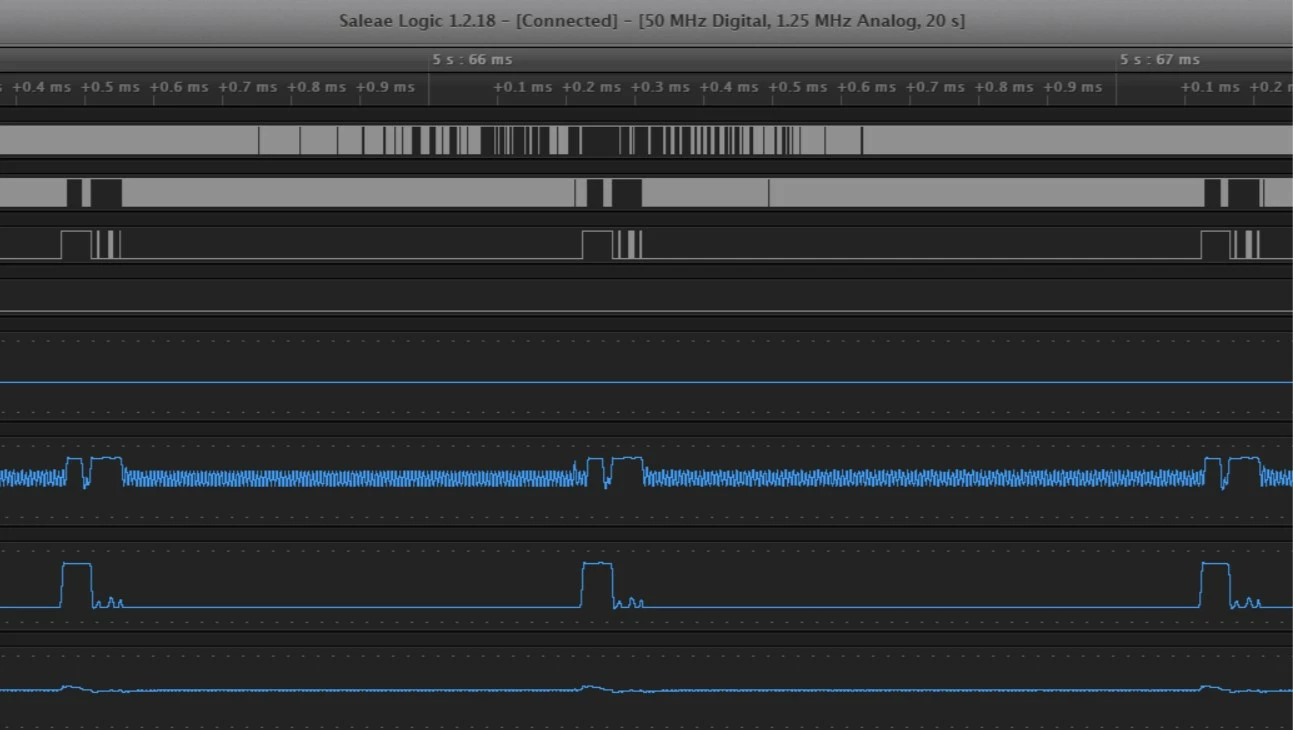

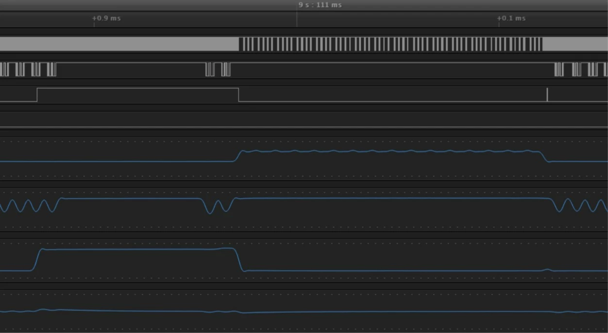

But, I still don't understand why my SD Card interface is not working (looks like the clock is not functioning correctly):
signal 1 is SDMMC1 clock
signal 2 is SDMMC1 CMD
signal 3 is SDMMC1 data bit 1
here is a bus capture of this project not working:
here is a bus capture of working interface:
any help will be greatly appreciated!!l
