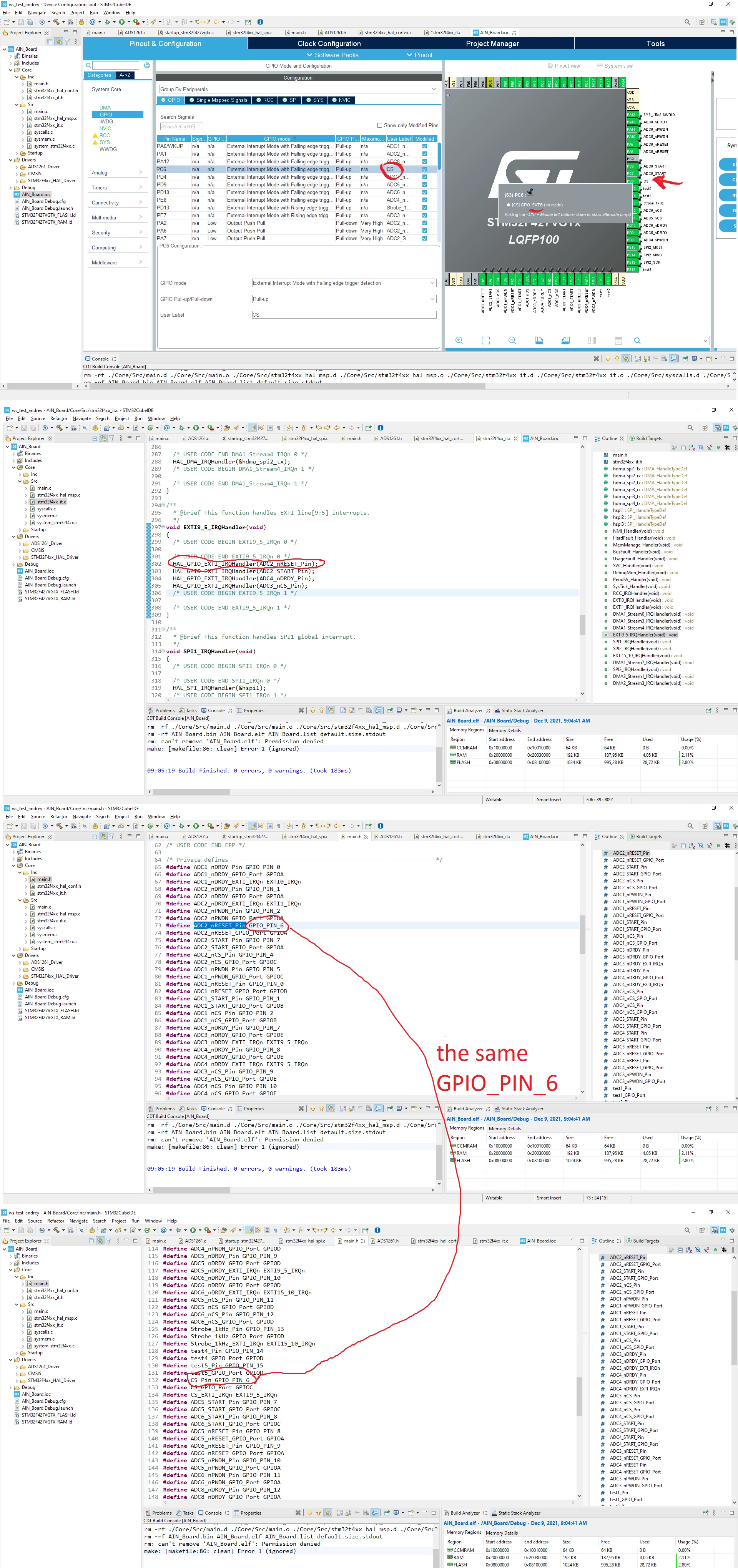

CubeIDE incorrectly generates the initial code of EXTI handlers: namely, it substitutes the wrong names with User Labels
Hello @AFinn.1 ,
Thanks for your feedback,
This issue was already detected with other STM32 and raised to the development team. I'll keep you posted with the updates.
** Taking the example of PC6 and PA6, both pins CAN be configured as GPIO_EXTI6 **
In EXTI9_5_IRQHandler(), user will find the following HAL_GPIO_EXTI_IRQHandler(Output_PA6_Pin) instead of HAL_GPIO_EXTI_IRQHandler(EXTI_PC6_Pin);
Workaround :
Either remove PA6 user label or set its state to reset state, this will give you a correct generated code.
Sorry for any inconvenience that this may cause.
