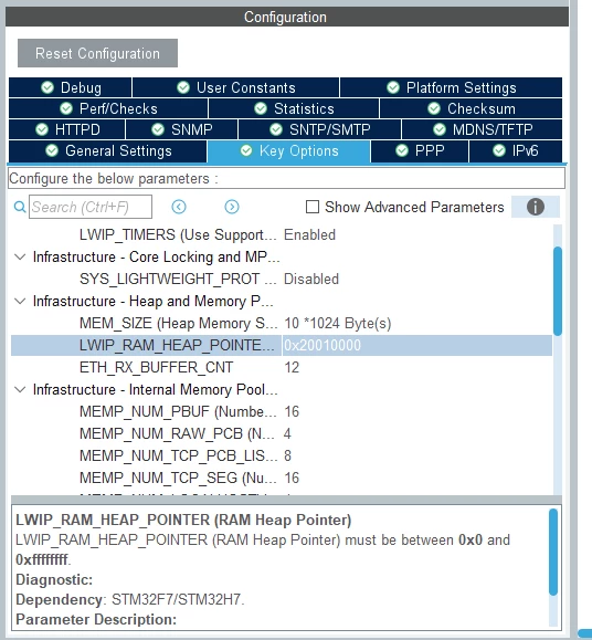

Jan 10, 2025 8:08 AM UTC
thanks for saving my day, I'm using STM32CubeMX version '6.13.0' to generate code and got the error as you said above, I wonder if ST has fixed that error or has a guide because it's very inconvenient every time I generate code again.
and one thing I just discovered is that previous versions of STM32CubeMX don't seem to generate anything similar to #define LWIP_RAM_HEAP_POINTER 0x30004000
UPDATE: I found a way to fix this problem, just change the address of LWIP_RAM_HEAP_POINTER to sram

Jan 10, 2025 10:09 AM UTC
I too changed the value in that field to 0x20010000 (sram) but I was not confident in the fix, having drilled through the macros that LWiP uses.
As far as I could figure out, if LWIP_RAM_HEAP_POINTER is not defined, it will just allocate space for a variable of the required size, plus alignment. Thus leaving it up to the compiler to allocate scalar storage space from the heap. However if I define this to be the start of ram (where the heap would normally grow from) how do I know that there is nothing else using that location, or that the compiler hasn't alreay allocated space at that address?
Clearly I could be mis-reading this, but to me it looks like an arbitrarily chosen ram pointer, which the compiler would not be aware of. Please tell me I'm wrong so that I can have confidence in this!
