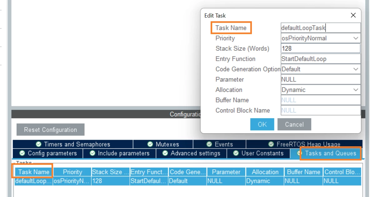

Cube MX FreeRTOS Tasks vs Threads confusion
Cube MX seems to constantly confuse FreeRTOS Tasks and Threads.
Term Tasks is being used where Threads are being actually configured.
In FreeRTOS Tasks and Threads are two different beings.
This is super confusing.

It is even more confusing if you consider that the CMSIS OS wrapper osThreadNew calls FreeRTOS xTaskCreate to do the work.
Can you give a reference/definition please? The only thing I find in the The FreeRTOS™ Reference Manual are vague sentences like "Each task has its own array of pointers that can be used as thread local storage.", hmm.

Those are the same thing. The general term is "thread", but unfortunately the FreeRTOS calls them "tasks" and creates a confusion. Almost everyone else, including both versions of the CMSIS-RTOS calls them "threads". As ST is using the CMSIS-RTOS API anyway, they should have used the term "thread" everywhere, but hey... we are talking about the HAL/Cube "experts" here!
Also do not confuse it with FreeRTOS Co-routines, which are going to be removed in the next FreeRTOS release anyway.
The term "task" is more appropriate for cooperative schedulers without multithreading. Setting a simple flag in a global variable is the simplest form of such.

and in top pic "edit task" everything is correct. except you believe only in Intel marketing , but then you should use Intel products only.

It is all about consistency, not tradition, marketing or history, and lack of consistency results in confusion.
FreeRTOS and ARM CMSIS RTOS2 wrapper for FreeRTOS delivered with Cube MX does differentiate Threads and Tasks. Generated code correctly includes Thread in variable names while GUI configurator mentions Tasks. It is a simple fact.

You can think of a FreeRTOS application as comprising of multiple threads executing in a single process. However, as FreeRTOS doesn't have the concept of processes (in the Linux sense), to avoid confusion (?) we prefer to say "tasks" instead of "threads". In a rich OS there is a difference. In an OS like FreeRTOS there is really no difference.
Thread local storage is a common phrase, with a common understanding, so we still use "thread" in that context to avoid different terminology for the same concept.
That is a fact, which proves that the same thing having two names creates a confusion!
I cannot see how small RTOS not having processes at all creates any confusion. On the other hand calling threads, which small RTOS actually has, a tasks indeed creates a confusion. This topic is a good example of it - even after all the explanation, the topic author still thinks that threads and tasks in CubeMX are two different things...
