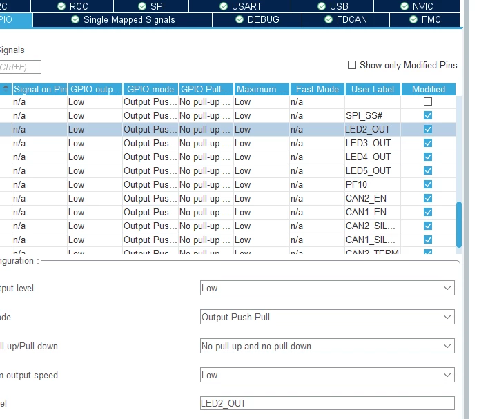

This is the state before code generation.
User labels are well reflected here

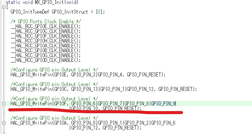

After generating the code, let's take a look at uVision.
The user label has come off.

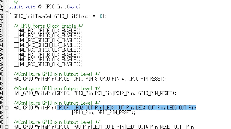

This is an old project, but it reflects the user label.0693W00000LzduEQAR.png
