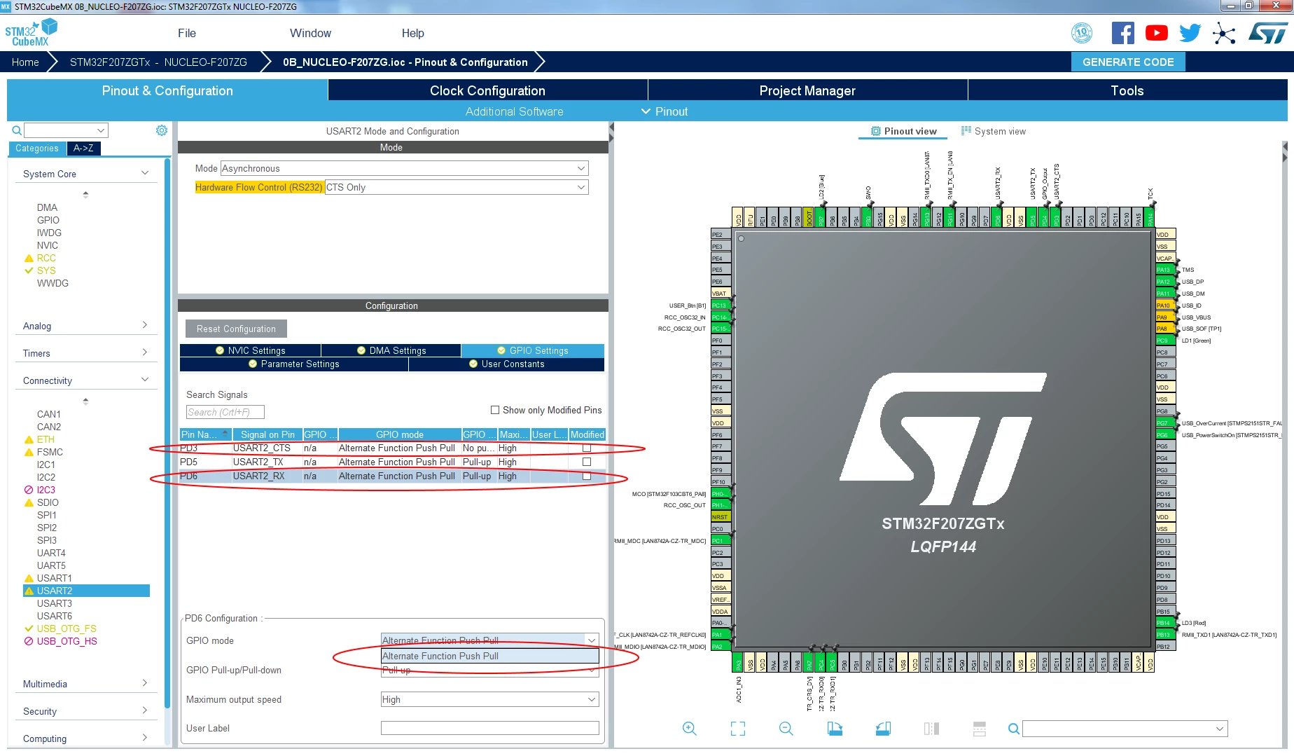

hi, I am working with the NUCLEO-F207ZG card and I have configured USART2 on port D.
Now CubeMx offers me the setting of the RX pin in Push-pull mode !!!!!! The same for CTS !!!
And there is no way to set the pin in any other way !!!
Can anyone give me an explanation ???

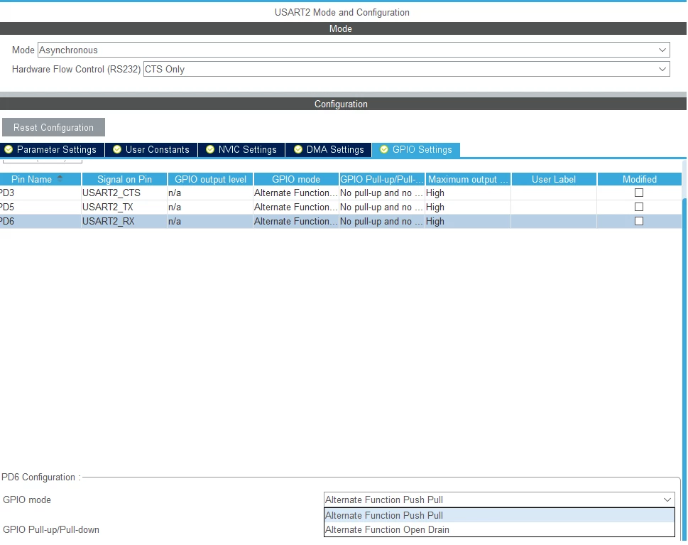

Hello @Zano,
After check with STM32CubeMX V5.6.0, it is possible to select open-drain mode for USART2_RX (see my attached screenshot).
so, please update and use the latest version of STM32CubeMX.

Nikita91
Lead II
Apr 2, 2020 11:30 AM UTC
It's OK.
In the ST terminology push-pull apply also to input!

Zanon.Luciano
Apr 2, 2020 12:58 PM UTC
Okay Imen,  thanks for your answer,
but this is still wrong in my opinion, cube-mx continues to set the usart RX pin as if it were an output.
Apr 2, 2020 1:04 PM UTC
According to the reference manual, we can add the "Open Drain" mode option at alternate function:
"When the I/O port is programmed as alternate function:
• The output buffer can be configured as open-drain or push-pull"
Zanon.Luciano
Apr 2, 2020 1:51 PM UTC
Ah .... thanks Imen,
so this means that by configuring a pin as an alternate function and when the alternate function requires the pin to be an input (usart RX) then the output buffer is automatically disabled and its configuration is superfluous .....
This also means that I have to read the manual better before posting questions like this :D
Apr 2, 2020 3:36 PM UTC
You are right, when the alternate function (USART RX) this means that the output buffer is disabled.
In fact, when the USART is used in single wire half duplex, the pin must be configured as alternate function open drain (as it is used for transmission and reception). The same when the IP is used in Smartcard mode.
