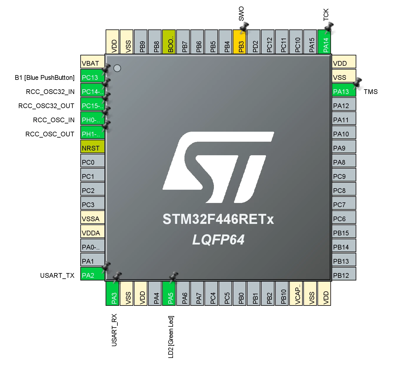

Creating a new project the evaluation board CUBEMX is not setting the pins
Hello!
On CUBEIDE V1.3.0 I am designing a project STM32 and on goal section, I choose evaluation board (Nucleo-F446RE).From the above mention board I still not receiving the pin out after choosing initialize al peripherals with their default mode to yes. If we select No the situation remains same.
Any one has any idea at which step I am making mistake?
Thanks.

Tried to re-produce without success. I am using CubeIDE on Windows 10. Creating a project targetting the board NUCLEO_F446RE. Pin-out looks like this assuming you select to initialize all peripherals in their default modes == Yes.
  0693W00000FAVeqQAH.pngThere you have the result from this operation on my machine. Maybe you can just copy-paste the settings based on this screenshot?
  • Which OS are you running on?
  • Same issue if you start a new board project targeting the same board in a new workspace?
  • What if you create a project for another board, is init of periph defaults always broken for all boards?
Trying to narrow down the issue a bit...
Kind regards, Mattias
