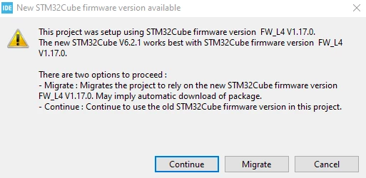

So what is your question? Which pill to take, blue or red?

RFlec.1
RFlec.1Author
May 3, 2021 2:12 PM UTC
Both Versions are the same. How many times do you suggest I should migrate?
Many Greetings!
Remo
