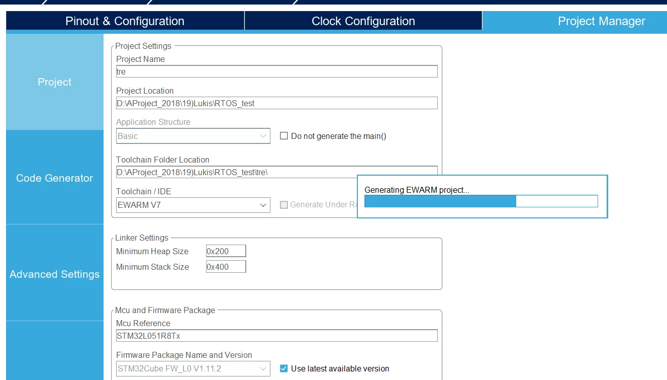

CPU : STM32L051R8T6 I set the RTOS for above CPU with STM32CUBEMX ver5.1. However it is not generate project file. When the progress is going but at the "Generating EWARM project..." section has stop . I wonder the reason. I need your help.

I've seen some of these. Could be many causes. I won't touch on reasons though.
When it occurred for me it was pretty reproducible, and mostly successful after closing any apps that could hold a lock. I'm Windows, so included Windows Explorer too.
You might learn something from its log. In Windows it's at C:\Users\<username>\.stm32cubemx.

I closed every folder and explore. But it is useless.
And I removed STM32CUBEMX  and reinstall but the same issue is happened.
Do you have another idea?
Maybe I will ask the engineer making STM32CUBEMX.

What errors are flagged in the log?

  1. The code gernaration has problem
            If I make the follow directory "D:\Project_2019\19)Lucis\code", the stm32cubemx emulation is stoped while making ewarm project file.
            but if make the follow directory "D:\Project_2019\Lucis_choi", the file is generated succefully however the file is not good(compile error is happened)
            I attached the file.
       ==> Pherhaps the jave affect the stm32cubemx, I recover the window os as default set.
              But it is useless, the symptom is same.
              I rellay wonder which one is wrong

I wasn't excited that you'd attached the entire project. Better if you'd posted only the error message. Anyway I downloaded it and it builds fine for me. Your IAR is an earlier version as it said its project was an old format and would I like to convert it. Mine is V8.32.3.
Don't do this. STM32CubeMX has many more important problems to fix than this.
