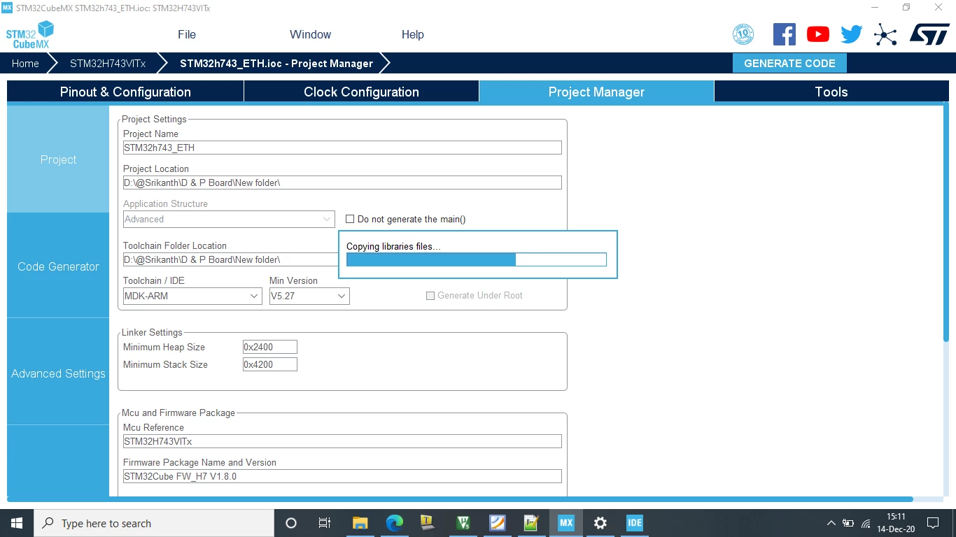

copying libraries error in cubemx v 6.1.0
I am unable to generate code to stm32 MCUs by using this cube mx v6.1.0
my pc is 64 bit and I installed jre-8u91-windows-x64.exe version.
I am getting Copying libraries files error to every controller0693W000006FcIHQA0.png, check in attached screen shot once.

Hello srikanth ,
Thanks for your feedback.
As I can see from your attached screenshot you're generating code using MDK-ARM toolchain and your Project Location includes a unsupported character "&",which is the cause behind this problem.
Actually this a known limitation and the request to add the CubeMX support for the special characters (&, ä, #,...) has been already raised internally. I will keep you posted.
As a solution for your problem, you have to delete the unsupported character from your project path and everything will work correctly.
I hope this will help you.
Thanks for your patience.

srikanth
srikanthAuthor
Dec 14, 2020 12:20 PM UTC
Thank you Khouloud sir, it is working fine .
