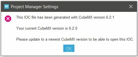

3) try to reopen the project with v6.2.0, these window will popup:
I need to use this project with 6.2.0 version of Cube MX.
looking into the .ioc from text editor, i see these lines:
MxCube.Version=6.2.1
MxDb.Version=DB.6.0.21
Changing these two into:
MxCube.Version=6.2.0
MxDb.Version=DB.6.0.20
with this change I can now re-open the file with previous CubeMX, is this procedure safe? There's something I'm missing that can broke the project?

Thank you for having reported. Actually, on project load, STM32CubeMX detects if the project was created with an older version of the tool and if this is the case, it proposes to either migrate to use the latest STM32CubeMX database and STM32Cube firmware version, or to continue.
Clicking continue keeps the database used to create the project untouched.
Assuming that you've clicked the Migrate button to use the latest STM32CubeMX version 6.2.1 and save the modification you've done, it will not be possible to use an older STM32CubeMX version.
What I can propose in this case is either to:
  • Change manually through a text editor MxCube.Version=6.2.1 and MxDb.Version=DB.6.0.21 to MxCube.Version=6.2.0 and MxDb.Version=DB.6.0.20 (make sure that the STM32Cube firmware version is remaining the same for both STM32CubeMX version 6.2.0 and 6.2.1)

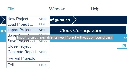

  • Start a new project based on the MCU you're already working with using STM32CubeMX version 6.2.0 and without doing any changes, select the Import project icon that appears under the File. Normally the project will be ported successfully:
0693W00000BbFq5QAF.jpg For more details about the Import project feature, you can refer to the STM32CubeMX User Manual.
