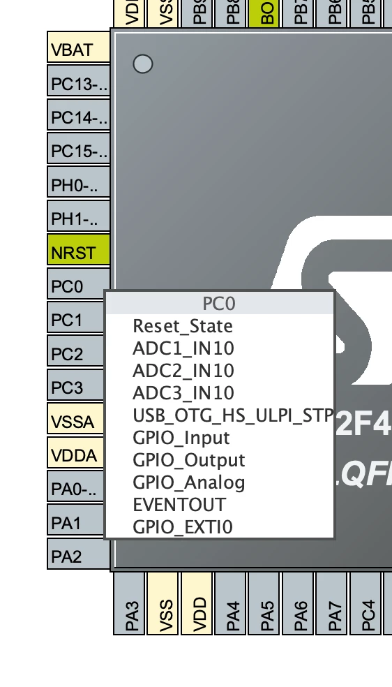

Studying the schematic, I can see the neopixel is connected via pin PC0. This is where I'm getting a bit lost - I *think* what I need to do is configure PWM using some timer settings somewhere (?), then connect this pin PC0 to that timer/pwm generator. But it's not clear to me how to do this in the cubeMX/visual configuration side of things.
I can see, when I click on some of the pins in the Pinout & Configuration settings, that some have timer options listed among the available settings. But PC0 does not:
So it's not quite clear to me how to proceed (and, again, I am VERY new to this, so just understanding the relationship between the timers and pins and all the configuration settings has put me in a bit of an overwhelmed state). How was it that this neopixel might have worked initially?
To check, your first entry point is always the documentation.
Regarding the pinout, you need to refer to the datasheet DS8626 / Table 7. STM32F40xxx pin and ball definitions:
As you can see PC0 doesn't have any TIM alternate function. So I think the Neopixel in your board is managed by GPIO and (maybe) driven by a timer.

  • It's theoretically possible to communicate with a neopixel via either pwm or spi - we want to send a strictly-timed stream of 0's and 1's to the neopixel, and these two 'languages' allow for some degree of control over timing. PWM is often used to simulate analog voltages, so it's easy to conflate PWM's use for dimming a regular ol' LED with its use speaking to a neopixel - in the latter case, we can use it as a digital signal, rather than as an analog approximation.
    The problem is that this particular board, the Adafruit STM32f405, has the neopixel connected to pin PC0, which lacks the ability to do either SPI or PWM, if I understand things correctly. (this strikes me as kind of an odd design choice).
  • Stumped by this, I hunched that whatever code this board ships with from Adafruit probably uses Adafruit's NeoPixel library: https://github.com/adafruit/Adafruit_NeoPixel. Reading through this code, I think I understand that it achieves speaking to neopixels mostly-irrespective of hardware through the use of assembly code.
Much of the examples I found online presupposed I am using a Nucleo board, or at least have some amount of control as to which pin I connect a neopixel to. The difficulty in this case is that I do not - the neopixel on the Adafruit Feather board is an SMD component physically wired to PC0, so I don't really have any choice about which pin to use. And this seems to affect what options I have to communicate with the neopixel.
NUCLEO or not, it's an STM32 MCU used. So need to adapt the code from any platform (Nucleo or something else) to you specific board, for example need to use PC0 in your case.  But in your case you are using stm32f405 on which PC0 is not having any Timer output function. So may be you need to control the timing using a Timer while setting the GPIO.
I've already provided some links. I think, the last link I provided is using TIM2/PWM.
