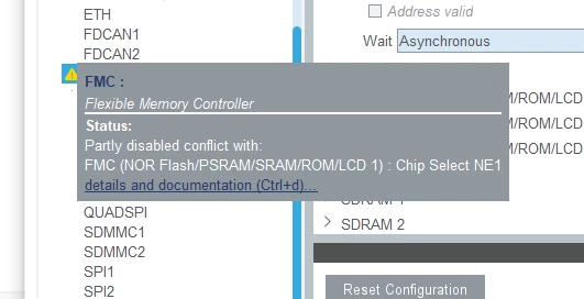

I need to use an SRAM with the STM32H743AII6 MCU. When I try to configure the project on CubeMX, a warning appears next to the FMC line. I feel like I should fix this before going further with the configuration.
I am curious why I am getting this warning even when FMC is the only peripheral that was already configured. Has anybody experienced this before? Are there any suggestions to resolve this?
Here is a summary as background information:
  • The warning text says "Partly disabled conflict with FMC Chip Select NE1".
  • Warning stays even if I use NE 2/3/4.
  • The package is UFBGA169, and NE1 pin is available on that specific pinout.
  • CubeMX version is 6.11.0 but the issue was present with earlier versions as well.
  • A screenshot is attached below.

What message is showing when you pass the mouse cursor on the warning icon?
jd2Author
April 15, 2024
Hi SofLit,
Here is the message:
Best,
JD
mƎALLEm
April 15, 2024
I think you can go ahead and ignore that warning.
If you notice any missing in the FMC config in the generated code, you can notify us.

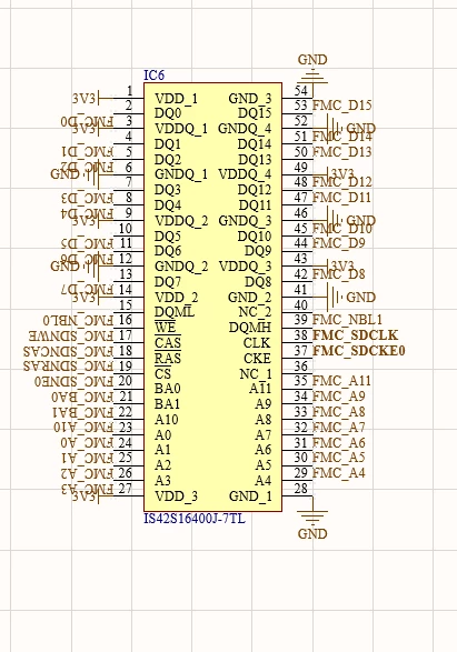

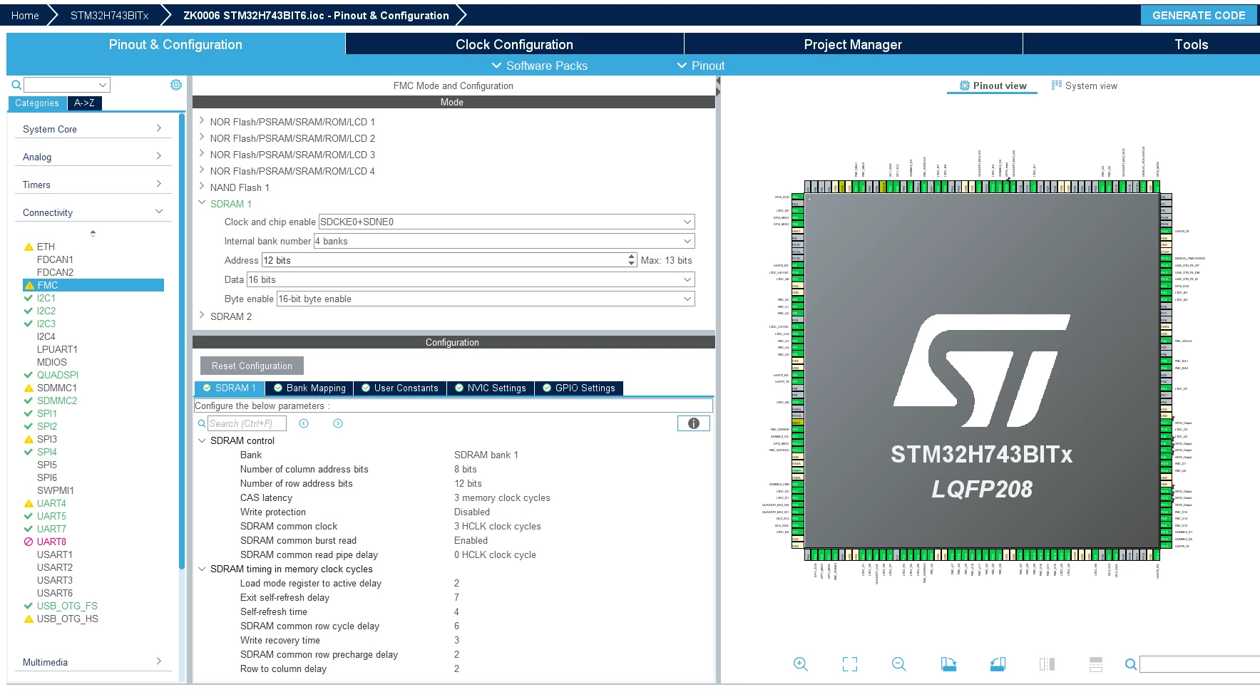

see my configuration I have the same chip connected to IS42S16400J-7TL (SDRAM 64 Mbit )

MNapi
Senior II
April 16, 2024
if you want to use the same memory chip
you need to initialize it:
