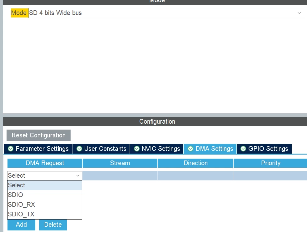

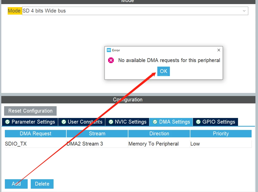

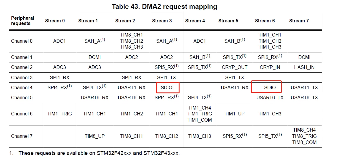

configure both SDIO Rx & Tx to work with DMA, but cubemx couldn't do this.
  • May 6, 2022
  • 1 reply
  • 1014 views
other SDIO cannot be configured after one of them configured with DMA.
