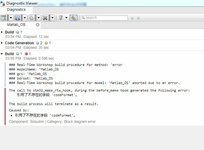

Component: Simulink| Category: Block diagram error Refer to the filed that does not exist 'codeFormat'.
  • May 7, 2019
  • 3 replies
  • 2470 views
The matlab version is 2019a;
The STM32CubeMX version is V520;
The stm32-mat/target version is V442;
I use matlab&simulink and stm32CubeMX to develop stm32f746Discovery.
For more information, please refer to the attachment

I don't know if the STM32-Mat/Target has been tested with R2019a, nor do I know if this is the issue.
You may want to try R2018b or R2018a.

I have a same error, did you have solve it?

This problem is solved with the version 5.1.0 of STM32-MAT/TARGET, published end of July 2019.
