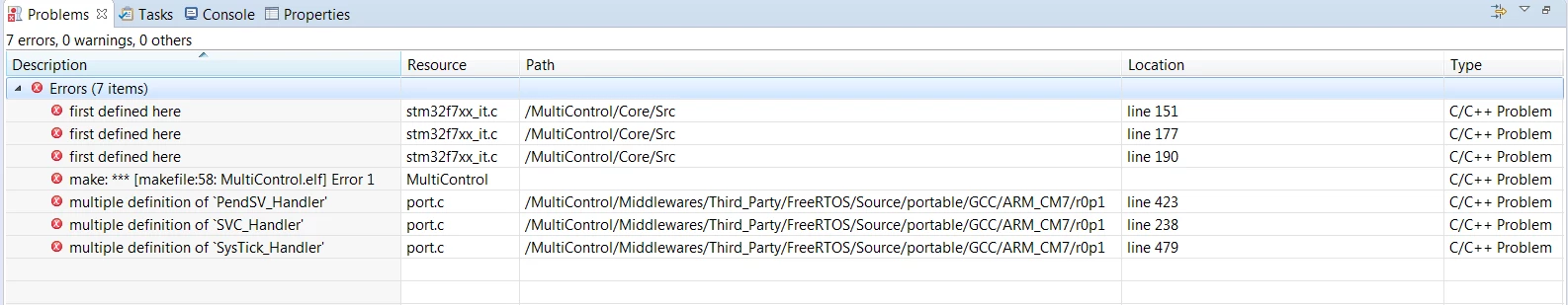

In the attached .ioc file, when FreeRTOS V1 is enabled via Cube, the project does not compile and gives errors. The errors image is also attached.

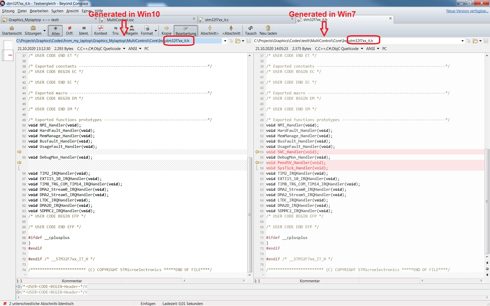

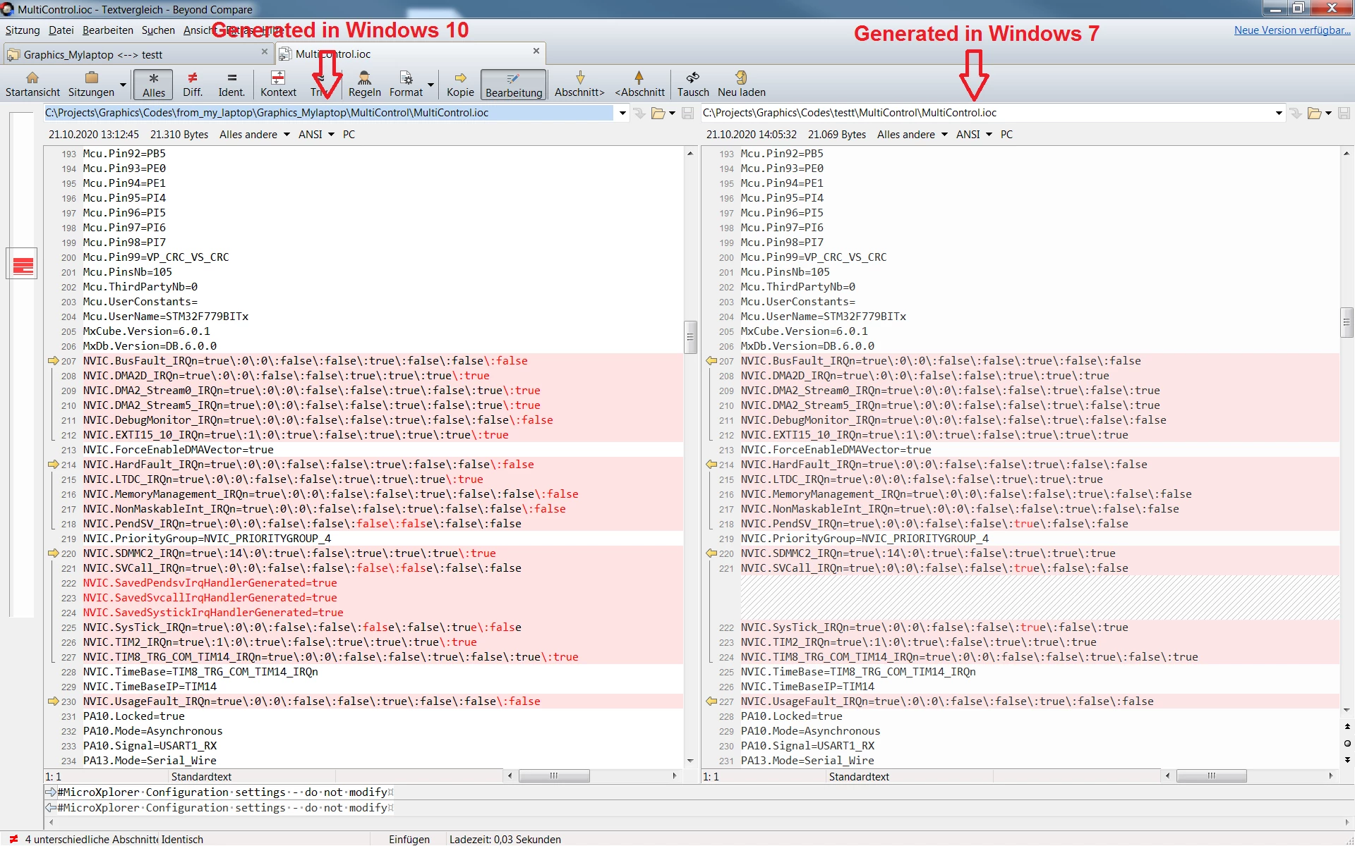

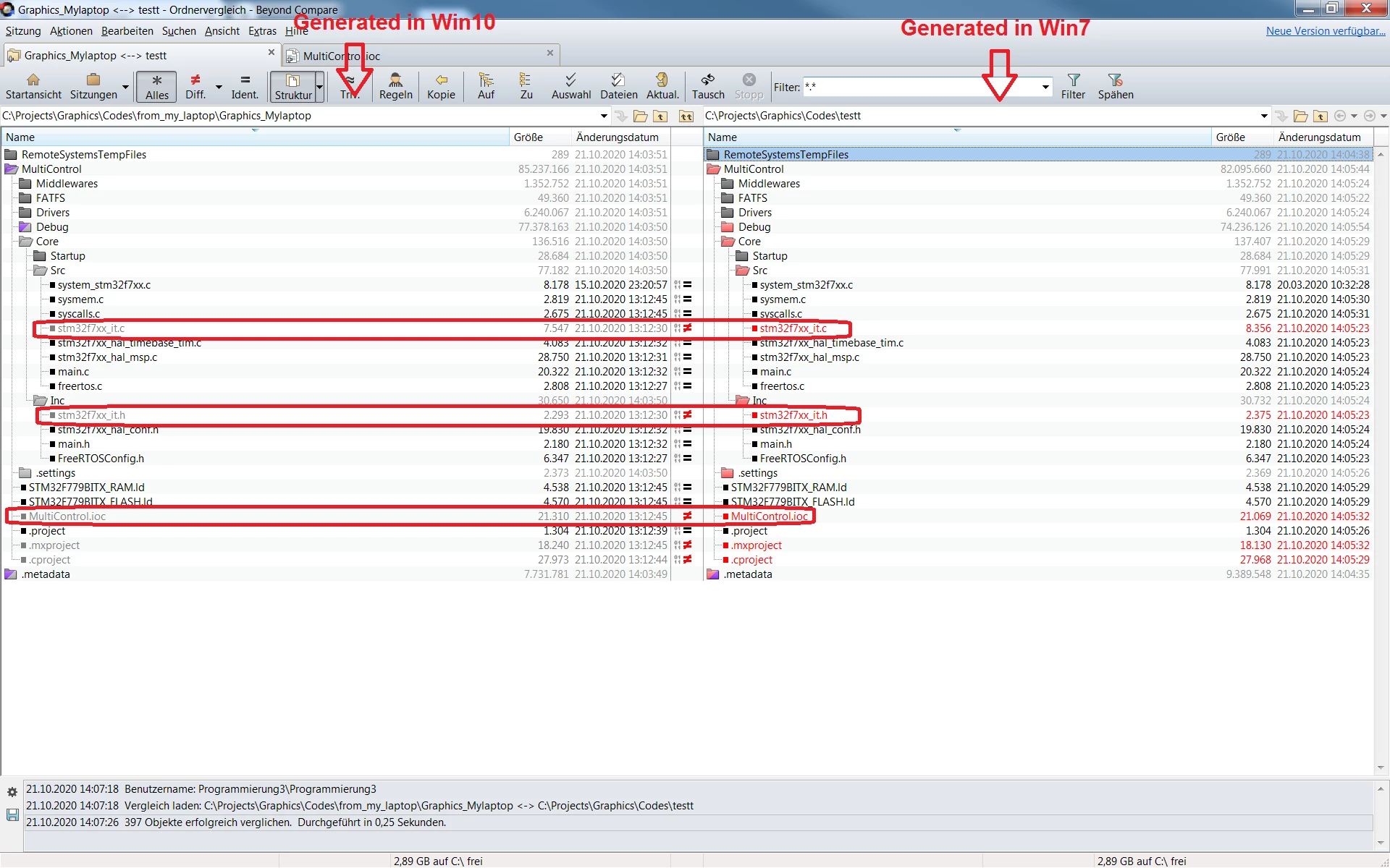

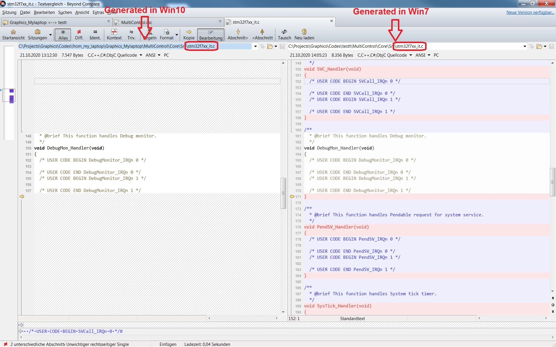

For this problem I found that the code generated from the same file (attached file in first post) is different on two PCs with the same version of STM32CubeIDE (V1.4.2). I have shown these differences in the attached photos. The difference between the two systems is that one is Windows 10 and the other is Windows 7, and the project created in Windows 7 is not compiled with errors that shown in first post.
Compare .ioc files:
0693W000004KX4vQAG.pngCompare project files:
Compare header files:
Compare source files:
