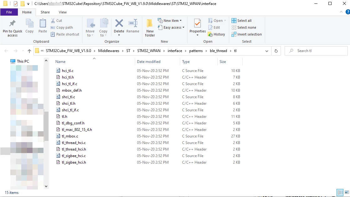

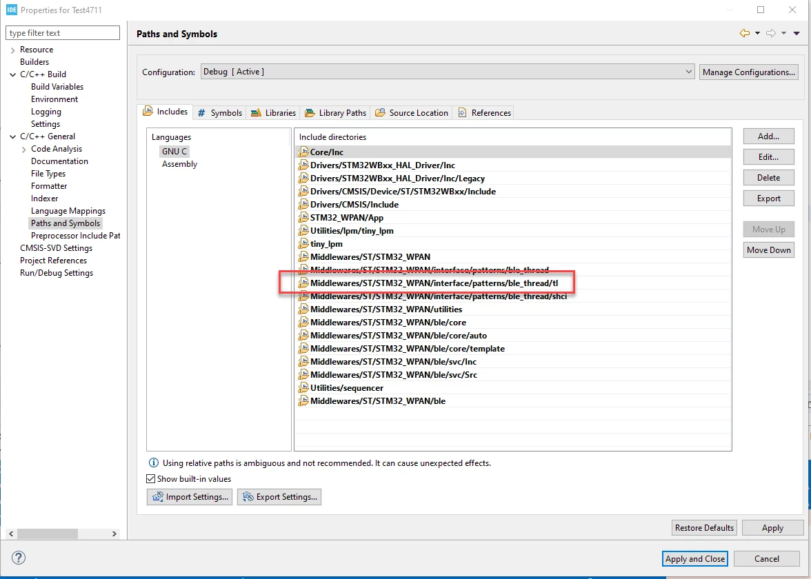

The file seems to be present in this directory
<USER_HOME>\STM32Cube\Repository\STM32Cube_FW_WB_V1.9.0\Middlewares\ST\STM32_WPAN\interface\patterns\ble_thread\tl
and it seems that path is in the INCLUDE paths of my project...?
0693W000005ATqGQAW.png0693W000005ATtKQAW.pngWhich is the very same directory where tl_mbox.c fails to compile.
Why isn't the .h file found?

I was able to manually fixing the problem by adding the very same include path once again but this time as a fully qualified path starting with C:\Users\...
I noticed that the bottom of the include path dialog (see above) mentions "Using relative paths is ambiguous and not recommended..." - which seemed to have cause the problem here. Yet all the other include paths apparently work as expected. So I'd still like to understand what the root cause is here, because using path relative to my workspace should work, right? Am I missing a system environment variable maybe?
