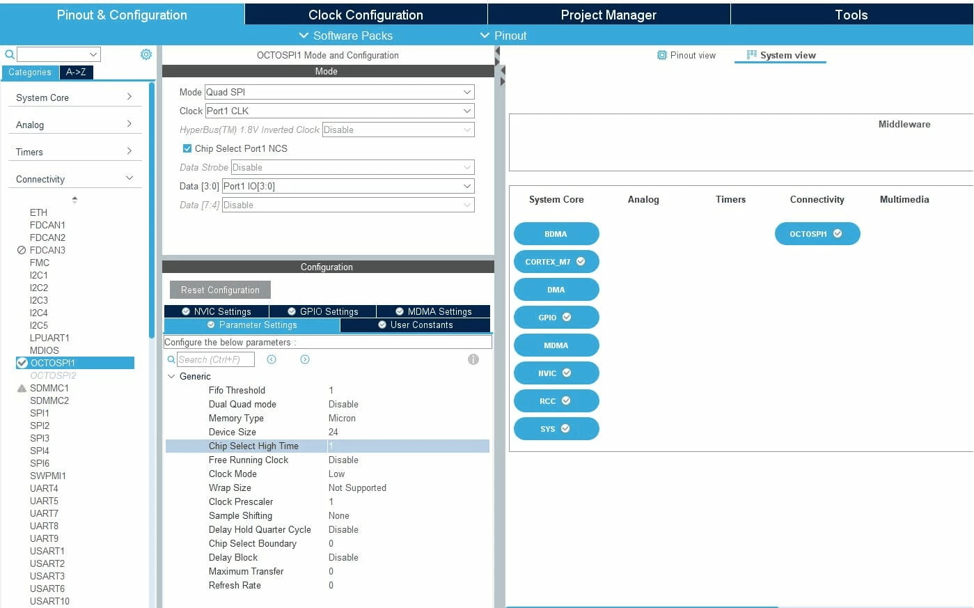

Hello, I have a very basic setup of OSPI1 on STM32H730VBT and I am trying to read the 1st Status Register of the Winbond W25Q128JV.
Environment
  • STM32CubeMX: 6.5.0
  • STM32Cube_FW_H7_V1.10.0
  • STM32CubeIDE Version: 1.9.0 Build: 12015_20220302_0855 (UTC)
Hardware
A custom board with STM32H730VBT and Winbond W25Q128JV connected via OSPI1.

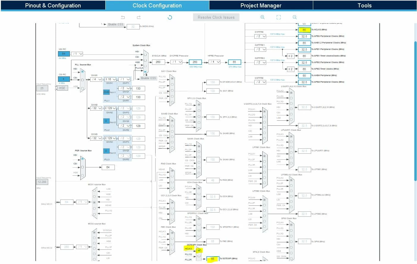

Everything works perfectly when using QSPI on STM32H750 (same board, same clock configuration output [doesn't exceed < Max 133MHz for O/QSPI]). However, when Octo-SPI (OSPI) is used, then nothing is being read. It looks like the CLK signal is not present.
Any ideas what can be tried out?
Best answer by GCern.1
@Andreas Bolsch​, @Community member​, thank you for the assistance. The issue turned out to be the clock.
7 replies

Do you have a UART available for debug on this board? Which ports/pins?
sOspiManagerCfg.IOHighPort = HAL_OSPIM_IOPORT_NONE; // ??
Try
sOspiManagerCfg.IOHighPort = HAL_OSPIM_IOPORT_1_HIGH;
hospi1.Init.ChipSelectHighTime = 2;
hospi1.Init.ClockPrescaler = 4; // Perhaps shoot for 50-100 MHz
Had Winbond/Macronix parts working on NUCLEO-H723ZG here

@Community member​ ,
why?
Mentioned Winbond NOR-Flash is a Quad Mode (max) flash and OSPI has to be used in Quad Mode (Data[3:0]) - therefore, STM32CubeMX won't even generate `IOHighPort` setting, as it is equal to `0` anyway.
The
was added to be explicit here.
The HCLK3 used as OSPI clock source is already 65MHz which is already within propose frequency range.
Shouldn't play a big role here. Tried, no difference.

Andreas Bolsch
Lead III
May 17, 2022
Checking with read status register won't be indicative, as 0x00 is a perfectly legal (and expected) value. Try Read ID command 0x9F instead.
Furthermore, inspect all OctoSPI registers after each HAL call and compare their contents against RM, in particular OCTOSPI_SR might give a clue.

GCern.1AuthorBest answer
May 18, 2022
