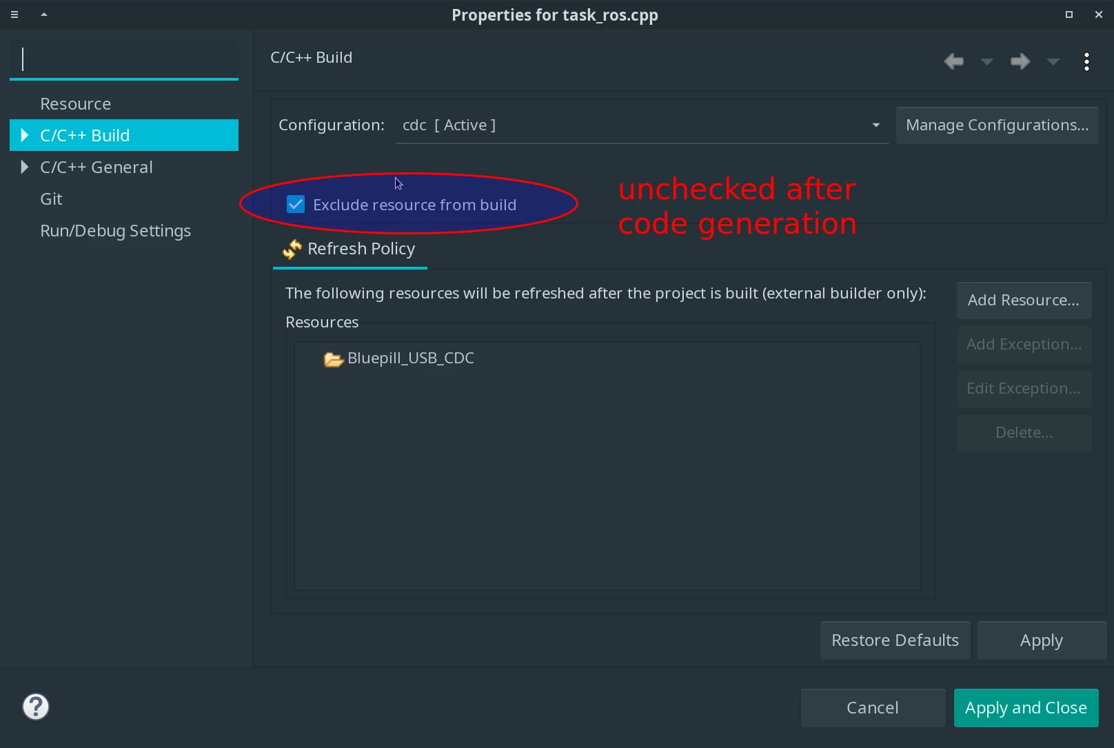

After generating code for the tool chain SW4STM32 the Eclipse project setting "exclude from build" for files or folders is reset:

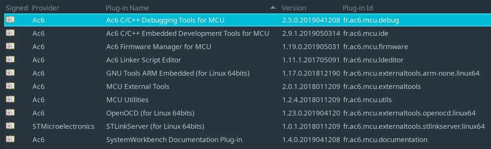

  • Eclipse AC6 plugins: 0693W000003PBBHQA4.png
Bug or feature ?
