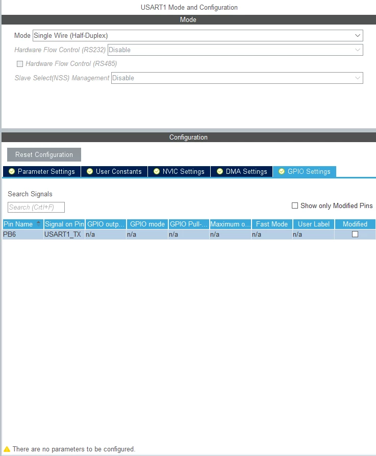

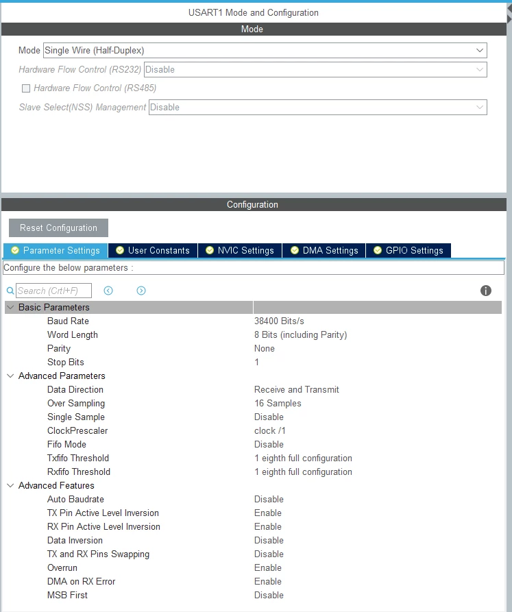

Code Generation Bug in STM32CubeMX ? Unable to generate UART (one wire half-duplex mode) pin configuration, resulting in the inability to use UART.
  • November 5, 2019
  • 1208 views
MUC: STM32G031G8Ux
STM32CubeMX version: 5.4.0
Package version: STM32Cube FW_G0 V1.3.0
Keil version: v5.28
void MX_USART1_UART_Init(void)
 huart1.Instance = USART1;
 huart1.Init.BaudRate = 38400;
 huart1.Init.WordLength = UART_WORDLENGTH_8B;
 huart1.Init.StopBits = UART_STOPBITS_1;
 huart1.Init.Parity = UART_PARITY_NONE;
 huart1.Init.Mode = UART_MODE_TX_RX;
 huart1.Init.HwFlowCtl = UART_HWCONTROL_NONE;
 huart1.Init.OverSampling = UART_OVERSAMPLING_16;
 huart1.Init.OneBitSampling = UART_ONE_BIT_SAMPLE_DISABLE;
 huart1.Init.ClockPrescaler = UART_PRESCALER_DIV1;
 huart1.AdvancedInit.AdvFeatureInit = UART_ADVFEATURE_TXINVERT_INIT|UART_ADVFEATURE_RXINVERT_INIT;
 huart1.AdvancedInit.TxPinLevelInvert = UART_ADVFEATURE_TXINV_ENABLE;
 huart1.AdvancedInit.RxPinLevelInvert = UART_ADVFEATURE_RXINV_ENABLE;
 if (HAL_HalfDuplex_Init(&huart1) != HAL_OK)
  Error_Handler();
 if (HAL_UARTEx_SetTxFifoThreshold(&huart1, UART_TXFIFO_THRESHOLD_1_8) != HAL_OK)
  Error_Handler();
 if (HAL_UARTEx_SetRxFifoThreshold(&huart1, UART_RXFIFO_THRESHOLD_1_8) != HAL_OK)
  Error_Handler();
 if (HAL_UARTEx_DisableFifoMode(&huart1) != HAL_OK)
  Error_Handler();
void HAL_UART_MspInit(UART_HandleTypeDef* uartHandle)
 if(uartHandle->Instance==USART1)
 /* USER CODE BEGIN USART1_MspInit 0 */
 /* USER CODE END USART1_MspInit 0 */
  /* USART1 clock enable */
  __HAL_RCC_USART1_CLK_ENABLE();
The pin configuration is not generated here,
Is this a Bug?

Khouloud ZEMMELI
November 5, 2019
​Hello @Swei.1885​ ,
Thanks for your feedback,
It will be internally checked.
Best Regards,
Khouloud
Khouloud ZEMMELI
November 5, 2019
@Swei.1885​  Issue will be fixed in the next release.
Regards,
Khouloud​
