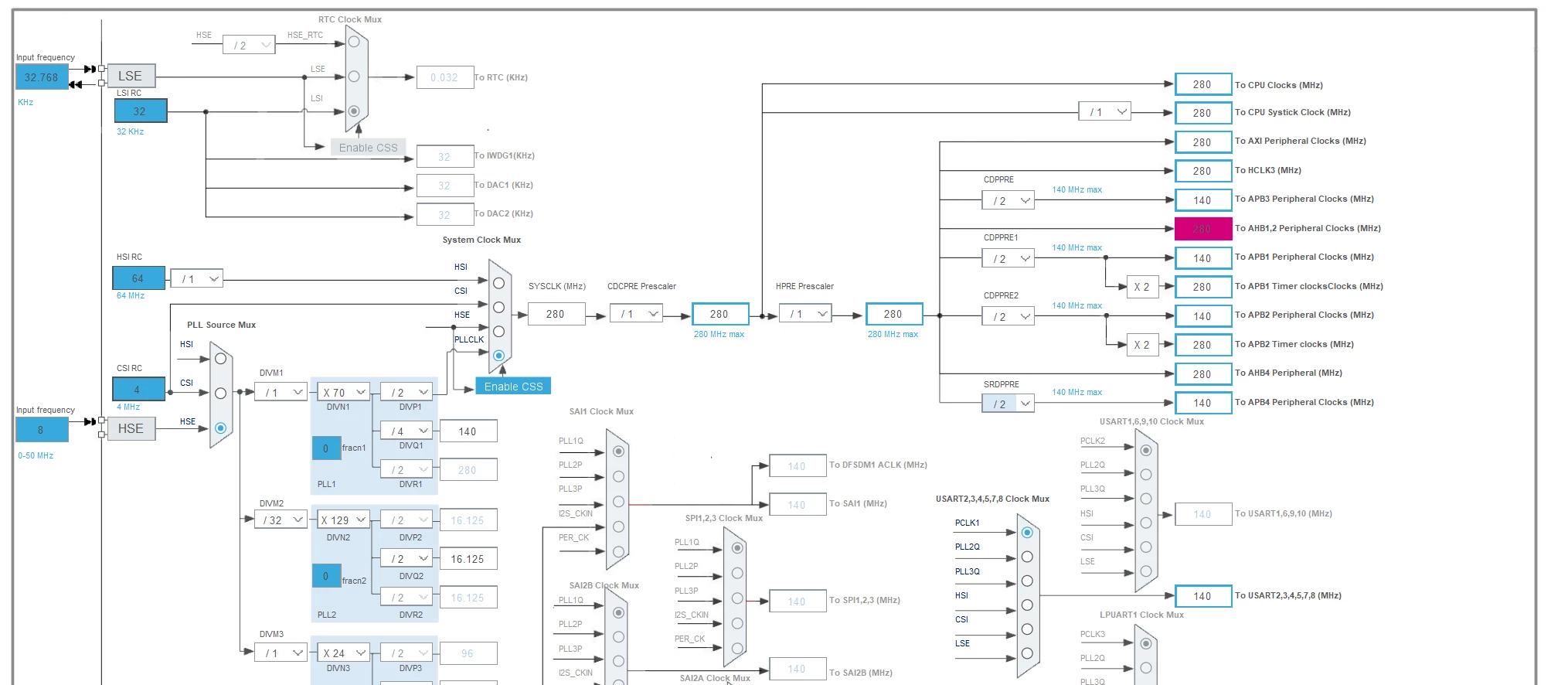

I started an empty project on CubeMX V5.5 (just updated) for a Nucleo-H7A3ZI,
I noticed that the clock default configuration for this board has a 64MHz clock.
If I change the multiplier on the PLL1 from x16 to x70 to get the max allowed 280MHz, I get an error on the 280MHz clock for AHB1,2 peripheral's clock.
However from the datasheet AHB clock can go up to 280MHz
Is this just a bug because this family has just appeared?
Regards,
Marco

Nesrine.JLASSI
Visitor II
Feb 18, 2020 9:06 AM UTC
Hello @Community member​
Thanks for the feedback,
It will be fixed next CubeMX version.
Best regards,
Nesrine

Marco.D
Marco.DAuthor
Feb 24, 2020 12:27 PM UTC
Hi Nesrine
I've installed the new version, the CubeMX is able to configure the clocks for 280MHz,
however the code generated for the CubeIDE seems to had 2 bugs, can you please confirm:

I think line 47 is wrong (SetAHBPrescaler is used in line 50), I believe it should be something like:
LL_RCC_SetSysPrescaler(LL_RCC_SYSCLK_DIV_1);
Also a line must be included to increase the programming delay (according to table 15 of the reference manual)
something like this after setting the latency (before line 13?):
 __HAL_FLASH_SET_PROGRAM_DELAY(FLASH_PROGRAMMING_DELAY_3);
Am I correct?
Thanks

Nesrine.JLASSI
Visitor II
Feb 24, 2020 2:06 PM UTC
Hi @Community member​
Function LL_RCC_SetAHBPrescaler cannot accept argument type LL_RCC_SYSCLK_DIV_2.
It should be LL_RCC_AHB_DIV_2.
For this line, __HAL_FLASH_SET_PROGRAM_DELAY(FLASH_PROGRAMMING_DELAY_3); I will check it with the development team then i will tell you.
Regards,
Nesrine

Marco.D
Marco.DAuthor
Feb 24, 2020 2:14 PM UTC
The clock is working ok because the AHBPrescaler is by default set to 1, however the programming delay is not set according to table 15, the (default) value for WRHIGHFREQ: Flash signal delay is 1 instead of 3.
