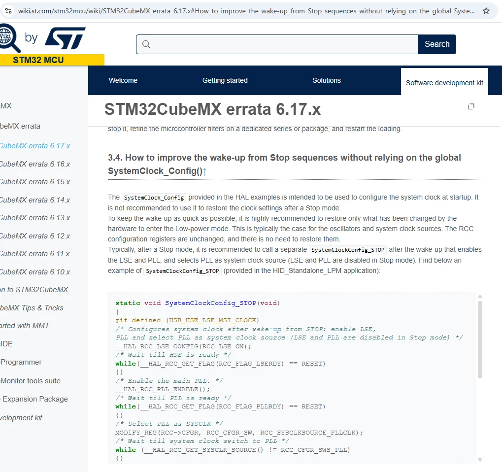

Clock config after STOP: example missing from v6.18.1 errata
All previous versions listed at https://wiki.st.com/stm32mcu/wiki/Category:STM32CubeMX_errata (viz, v6.17.x back to v6.10.x) had this example under How to improve the wake-up from Stop sequences without relying on the global SystemClock_Config():
(note the typo in the comment on checking LSE ready)

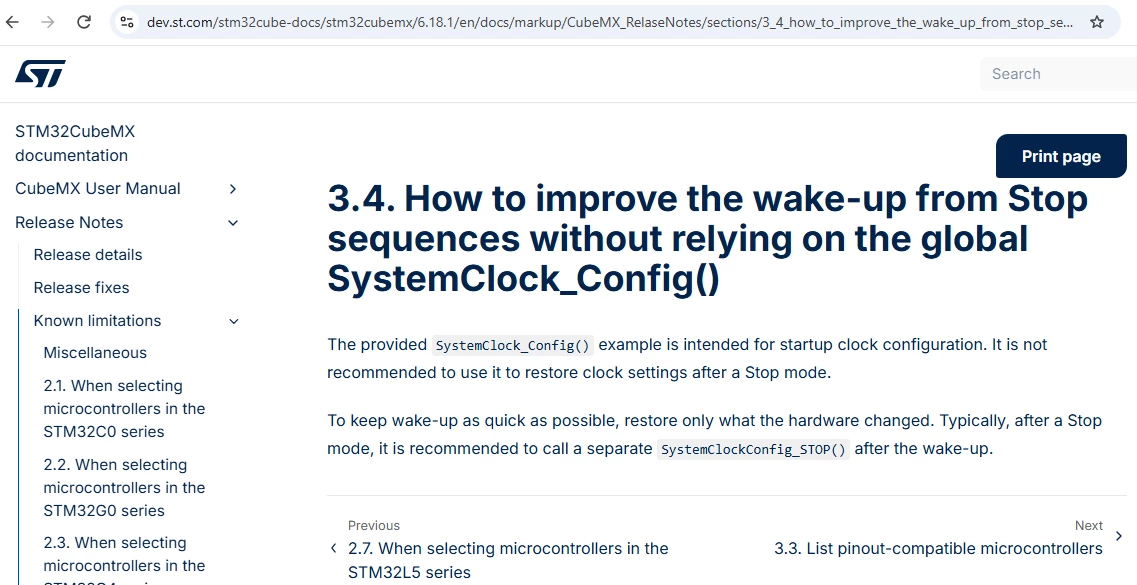

v6.18.1 still has the exact same erratum - but now there is no example:

Hello ​@Andrew Neil
Thank you for bringing this to our attention.
I will raise this issue internally to the dedicated team. Internal ticket number: CDM0066605 (This is an internal tracking number and is not accessible or usable by customers.)
