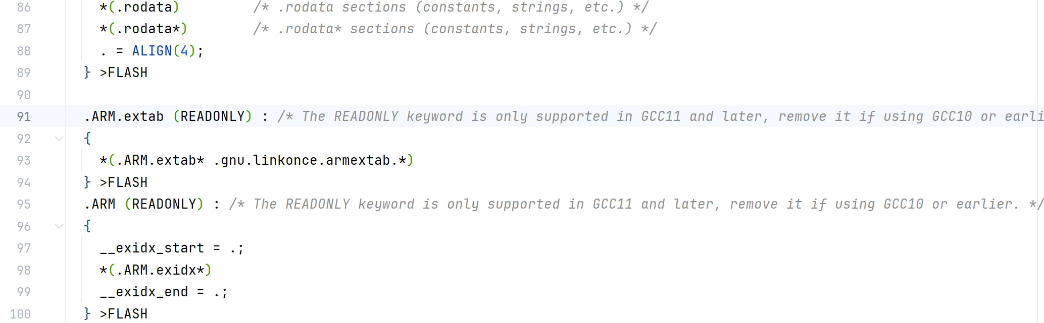

i can't understand why this is error:
d:/gcc-arm/bin/../lib/gcc/arm-none-eabi/10.3.1/../../../../arm-none-eabi/bin/ld.exe:C:/Users/19242/Desktop/Manipulator_clion/STM32H723VGTX_FLASH.ld:91: non constant or forward reference address expression for section .ARM.extab
collect2.exe: error: ld returned 1 exit status

Pavel A.Best answer
Mar 23, 2024 2:27 PM UTC
Remove "(READONLY)" in line 93 and everywhere below it.
.ARM.extab (READONLY) : /* The READONLY keyword is only supported in GCC11 and later, remove it if using GCC10 or earlier. */
 Or update your ARM toolchain to GCC 11 or newer as the comment says,

Pavel A.
Mar 23, 2024 1:35 PM UTC
This is linker (ld) error, it does not like something in the .ld file:
C:/Users/19242/Desktop/Manipulator_clion/STM32H723VGTX_FLASH.ld line 91
But you don't show us this file ((

*(.glue_7) /* glue arm to thumb code */
*(.glue_7t) /* glue thumb to arm code */
*(.eh_frame)
KEEP (*(.init))
KEEP (*(.fini))
. = ALIGN(4);
_etext = .; /* define a global symbols at end of code */
} >FLASH
/* Constant data goes into FLASH */
.rodata :
. = ALIGN(4);
*(.rodata) /* .rodata sections (constants, strings, etc.) */
*(.rodata*) /* .rodata* sections (constants, strings, etc.) */
. = ALIGN(4);
} >FLASH
*(.ARM.extab* .gnu.linkonce.armextab.*)
} >FLASH
.ARM (READONLY) : /* The READONLY keyword is only supported in GCC11 and later, remove it if using GCC10 or earlier. */
__exidx_start = .;
*(.ARM.exidx*)
__exidx_end = .;
} >FLASH
.preinit_array (READONLY) : /* The READONLY keyword is only supported in GCC11 and later, remove it if using GCC10 or earlier. */
PROVIDE_HIDDEN (__preinit_array_start = .);
KEEP (*(.preinit_array*))
PROVIDE_HIDDEN (__preinit_array_end = .);
} >FLASH
.init_array (READONLY) : /* The READONLY keyword is only supported in GCC11 and later, remove it if using GCC10 or earlier. */
PROVIDE_HIDDEN (__init_array_start = .);
KEEP (*(SORT(.init_array.*)))
KEEP (*(.init_array*))
PROVIDE_HIDDEN (__init_array_end = .);
} >FLASH
.fini_array (READONLY) : /* The READONLY keyword is only supported in GCC11 and later, remove it if using GCC10 or earlier. */
PROVIDE_HIDDEN (__fini_array_start = .);
KEEP (*(SORT(.fini_array.*)))
KEEP (*(.fini_array*))
PROVIDE_HIDDEN (__fini_array_end = .);
} >FLASH

Pavel A.
Pavel A.Best answer
chenmoAuthor
Mar 23, 2024 2:47 PM UTC
thank you!!!!
it works!
