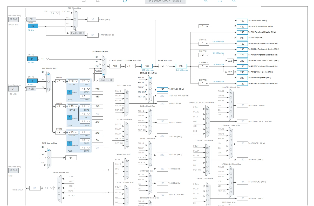

Changing over to CubeMX 6.2.1 gives issues in my project with clock settings
I have a working project on STM32H750VBT6 with multibootloader and executing code from external Flash. When changing to CubeMX6.2.1 clock configuration reports issues although nothing has been changed. How to solve?

The project is a small color display with touch, where I run with TouchGFX a demo on with several pictures. The interface is RGB, for the rest there is an external Flash where the code is executed from. This project works fine till change over to CubeMX6.2.1, no picture anymore, seems like dead.
The project has a multi boatloader with it's own .ioc file. And a main project wit it's own .ioc file. It is the Multibootloader project .ioc file where the clock setting issue is reported. Not sure if this is the root cause of the issue.

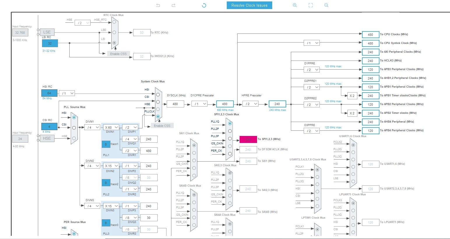

I added screenshots of the Clock Config when using CubeMC6.1.1 and 6.2.1. Both opening the same project, nothing changed in code nor settings. You can see the SPI clock of 240 MHz seems to give an issue. Prescaler of both has not been changed and set at 4. When I solve the issue by changing the PLL divider or using other clock like PER_CK, I can generate code, build the project, but my project does not work at all.
Although the SPI is configured I do not use it in my hardware so I think still something else has to be changed in settings.
The project has a multi bootloader with it's own .ioc file.
In migrating top the 6.2.1 I also had to switch in the repository to FW_H7_V1.9.0 (from V1.5.0)
As nothing has been changed in code nor in settings I am puzzled about what to do to solve this.

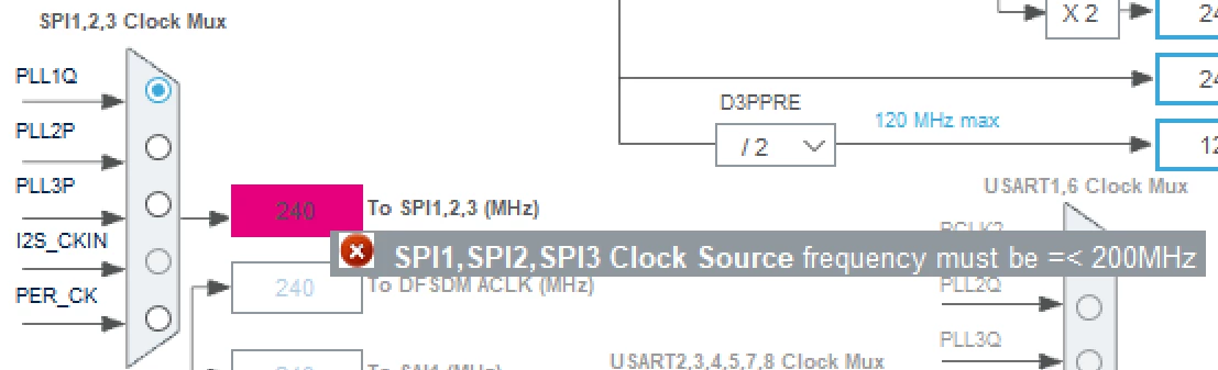

Hover over the error to find the cause. In this case, most likely:
To fix, change the PLL1Q clock to 200 MHz or under, or choose a different clock for SPI that satisfies the restriction.

Thanks for your fast answer. I did adapt already as you described, strange however I do not get this error with version 6.1.1.
As indicated, I do not use the SPI interface, it looked however strange.
Still my hardware (although nothing changed to code, except going over to the 6.2.1 of CubeMX with same settings and also going to the STM32Cube_FW_H7_V1.9.0 version) even the Xtal does not start....
Your project includes an spi.c file. Clearly, SPI is being used, or at least initialized.
