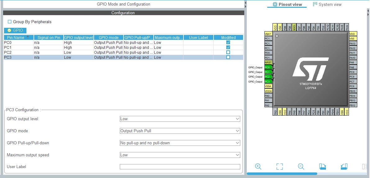

I searched in cubemx where to change the default value of gpio pins, but couldn't find it.
Does anyone knows ?
 In generated code, all output gpio are set to 0, for example :
HAL_GPIO_WritePin(GPIOK, SW_LED1_Pin, GPIO_PIN_RESET);
Thanks,

Hello ranran,
You can select the status of the GPIO pin (GPIO_PIN_RESET / GPIO_PIN_SET) by setting the GPIO output level to Low or High, as shown in the figure below.
Best Regards,
Mohamed Aymen.
