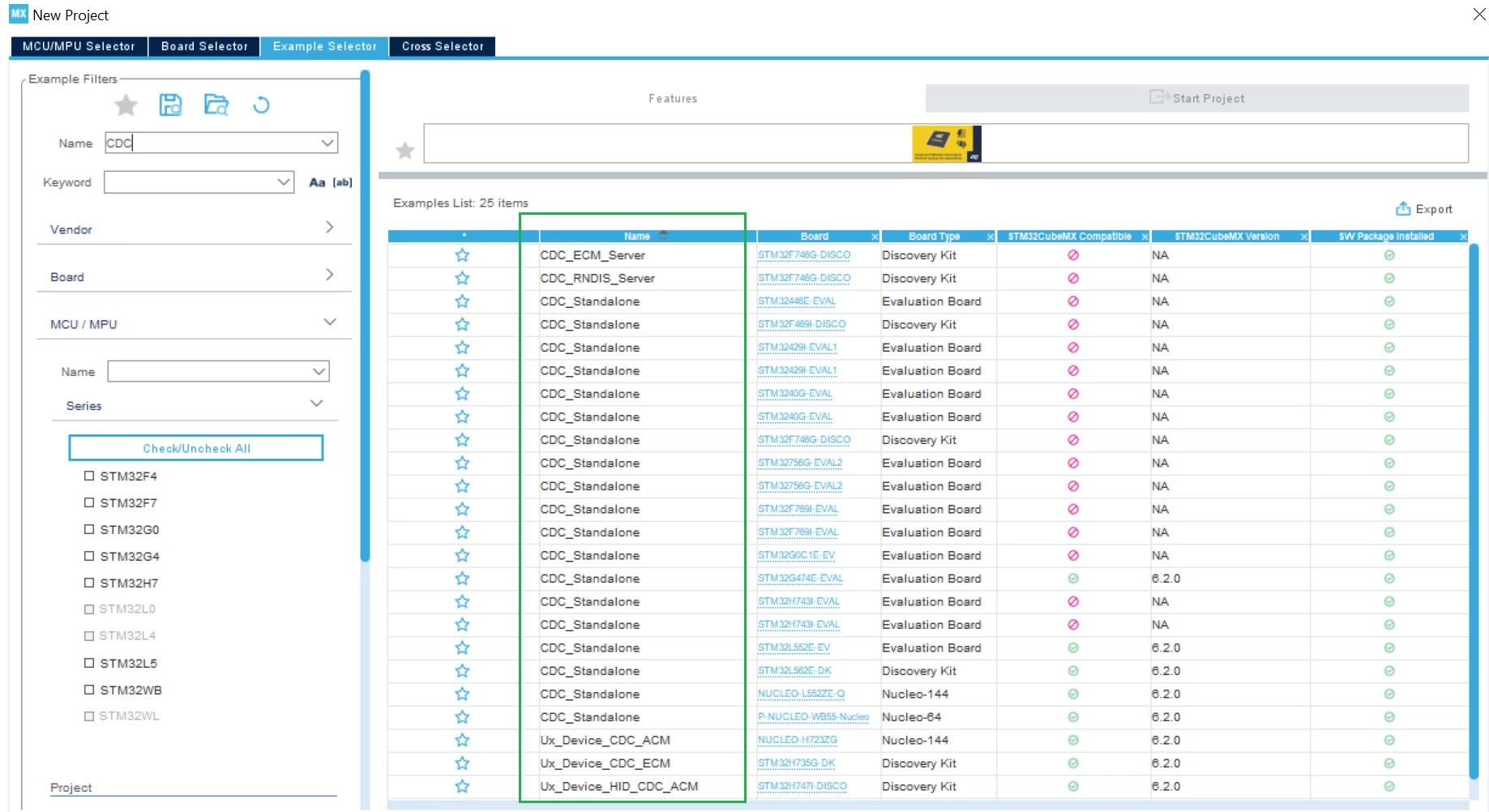

You're right, when generating USB CDC class from CubeMX, the CDC_SET_LINE_CODING and CDC_GET_LINE_CODING USB request are not implemented in CDC_Control_FS function in usbd_cdc_if.c file.
Actually, what STM32CubeMX delivers by default is a template for a project, without forcing the user to use a specific configuration as each one has his own implementation. Thus, we put the CDC_Control_FS void under user section to make each one able to add his own code and what CubeMX ensures is to keep it after regeneration.
With this being said,  I will bring this point up internally and see how we can address a modification to improve the usbd_cdc_if generated by CubeMX.
Meanwhile, the Example selector allows you to browse a large set of CDC examples and to start a project based on a selected example. Those examples may be a good start point to successfully create your project:
Thanks for your contribution.
Khouloud.
