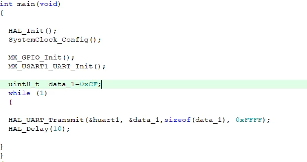

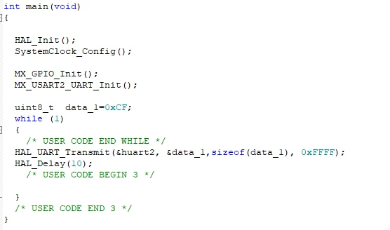

Hi All,
i'am beginner of using libary HAL, i use CubeMX to generate code. At first, I use usart1 to send message and i work, and then i try to use usart2 but i cant can't send any message.
these two code is almost the same.

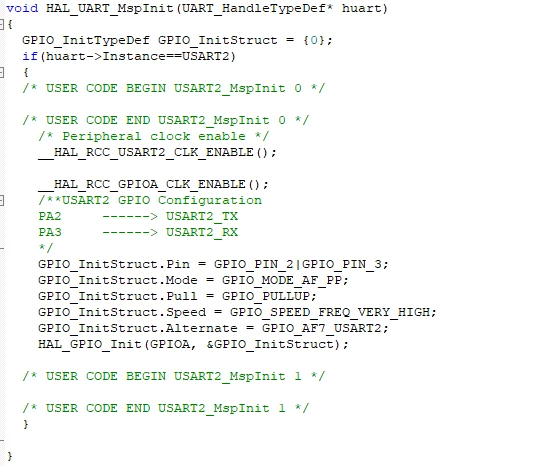

Elaborate, which chip and which pins/alternate functions?
A peripheral without configured pins is a blind guy.
HQIN.1
HQIN.1Author
December 26, 2019
0690X00000BuyAMQAZ.pngi used nucleo f401 so is stm32f401,
berendi
Principal
December 27, 2019
There should be no pullup (nor pulldown), and I/O speed should be low (unless the baudrate is higher than 4 MHz).
Check the board user manual, PA2 and PA3 might be connected to the onboard debug adapter by default, and not available on the pin headers, unless you modify some solder bridges first.
