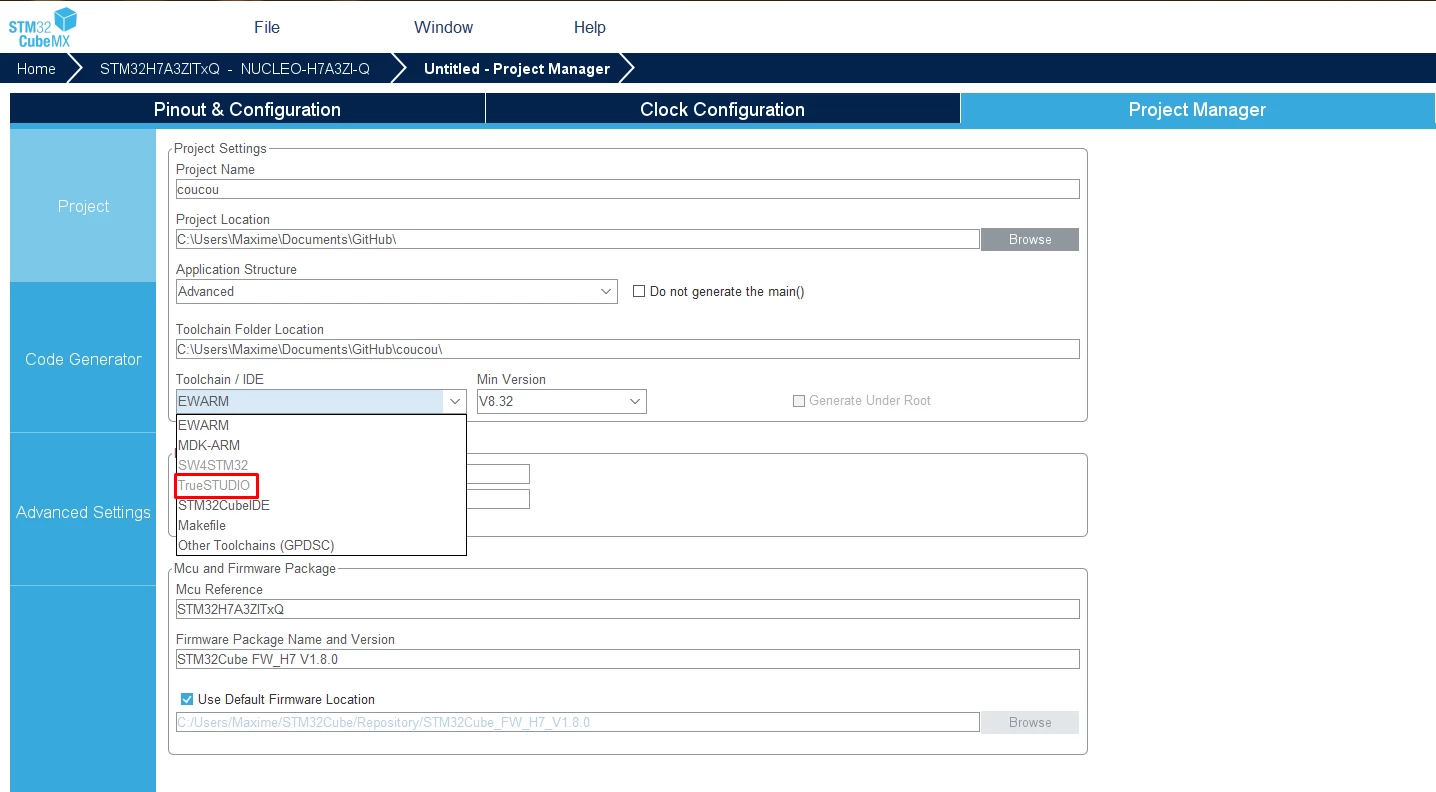

I use a STM32H7A3ZI-Q board, and I can't select TrueSTUDIO as IDE in the project settings ... Any idea ?
 0693W000006HJQLQA4.pngThanks for your support.
Maxime

Hello @Maxime​
The TrueStudio is no more supported for all new series, I recommend you to use the CubeIDE instead.
Thanks for your feedback, Khouloud

Hello @Maxime​
