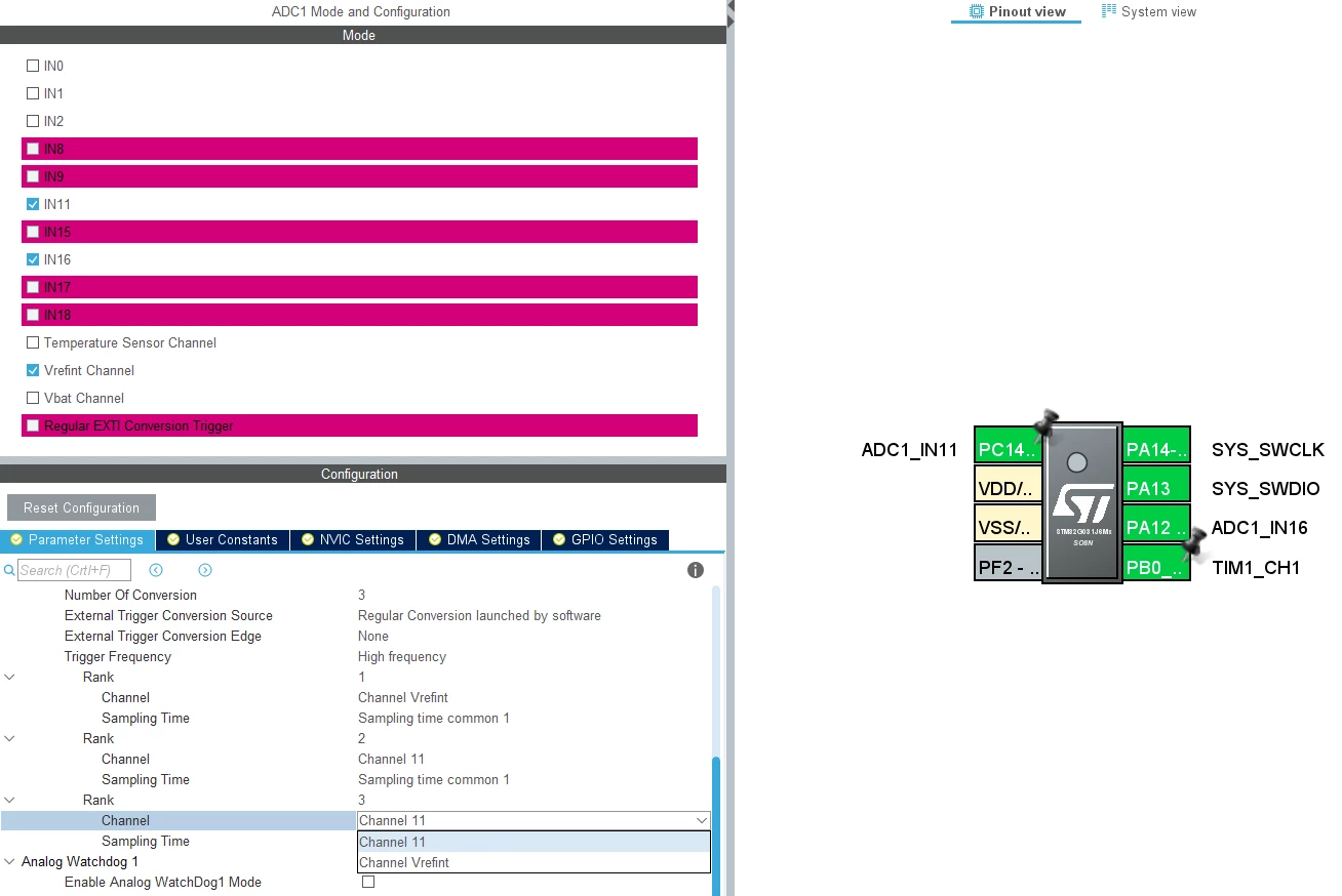

Cannot select ADC channel 16 with CubeIDE and STM32G031J6
I'm trying to enable ADC channel 16 on STM32G031J6 but the IDE does not list up the channel.
What is the matter? How can I enable the channel?

Hello @SKiri​ ,
When sequencer is set to "not fully configurable" => CHSELRMOD = 0 in ADC_CFGR1
=> ADC_CHSELR is up to 19 channels (CHSEL 0 to CHSEL 18)
When sequencer is set to "fully configurable" => CHSELRMOD = 1 in ADC_CFGR1
=> ADC_CHSELR is able to sequence up to only 8 channels (CH 0 to CH 14)
The Rank configuration can be done only in the "fully configurable" sequencer case, for that, you cannot choose Channel 16 under Rank.

Ah! I see!
Thanks a lot.​
