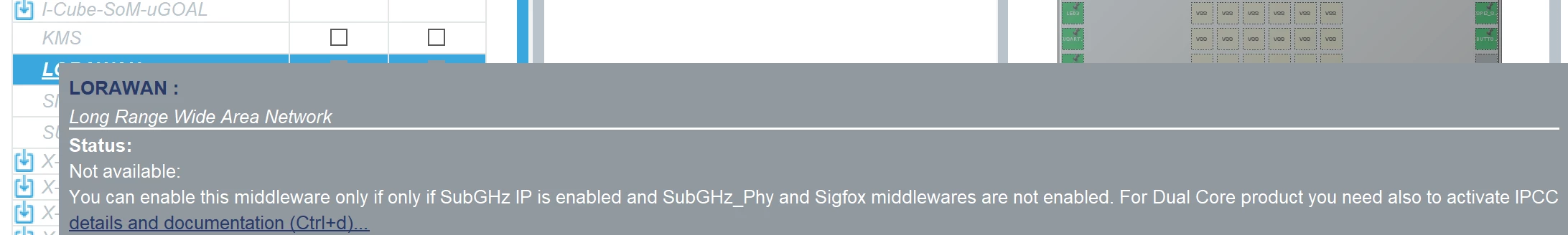

I am using STM32 CubeMX and am trying to add the LoRaWAN package but have this message ( see below). I am not sure how to fix ?
Any one have any guidence on this?

Hello @fabltd
You have first to enable the SUBGHZ api on the connectivity tab i think (it is an STM32WL).
