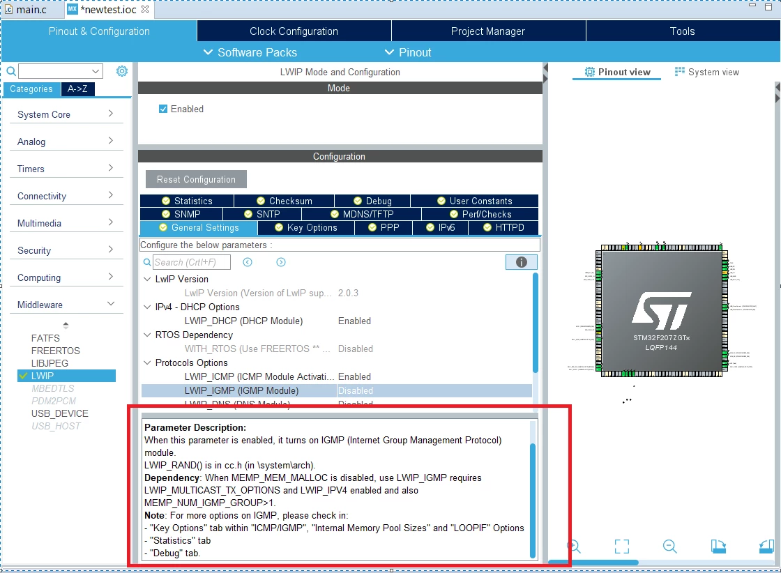

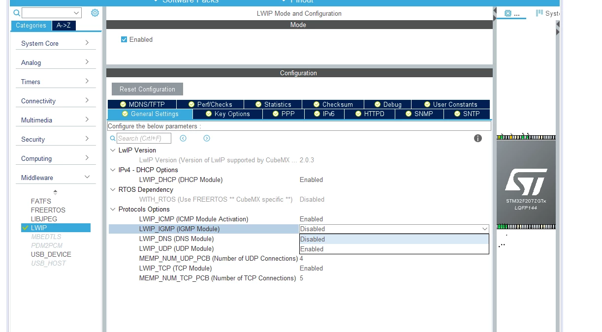

Cannot enable IGMP in STM32CubeIDE.
I am using a a very recent version of STM32CubeIDE (Version: 1.3.1) and STM32CubeMX (5.6.1.202004052303). I created a new project for the Nucleo-F207ZG board.
I have enabled LWIP and then enabled UDP but the "IGMP module" has no "enabled" option. Is there some dependency that I am missing?
Can anyone else enable IGMP?

Hi @paulrbryson​
Try to read this Parameter description:
You should:
  1. Enable "    LWIP_MULTICAST_TX_OPTIONS   "
  2. Enable "    LWIP_IPV4   "
  3. MEMP_NUM_IGMP_GROUP>1
Best regards,
Nesrine

paulrbryson
Jun 9, 2020 1:19 AM UTC
Wow thank you very much!
I had no idea that those descriptions were there. I may never have clicked on the "i" button and/or I never scrolled past the last parameter. Maybe I need a bigger screen and/or more monitors.
Also I never noticed the "Show Advanced Parameters" check box before.
