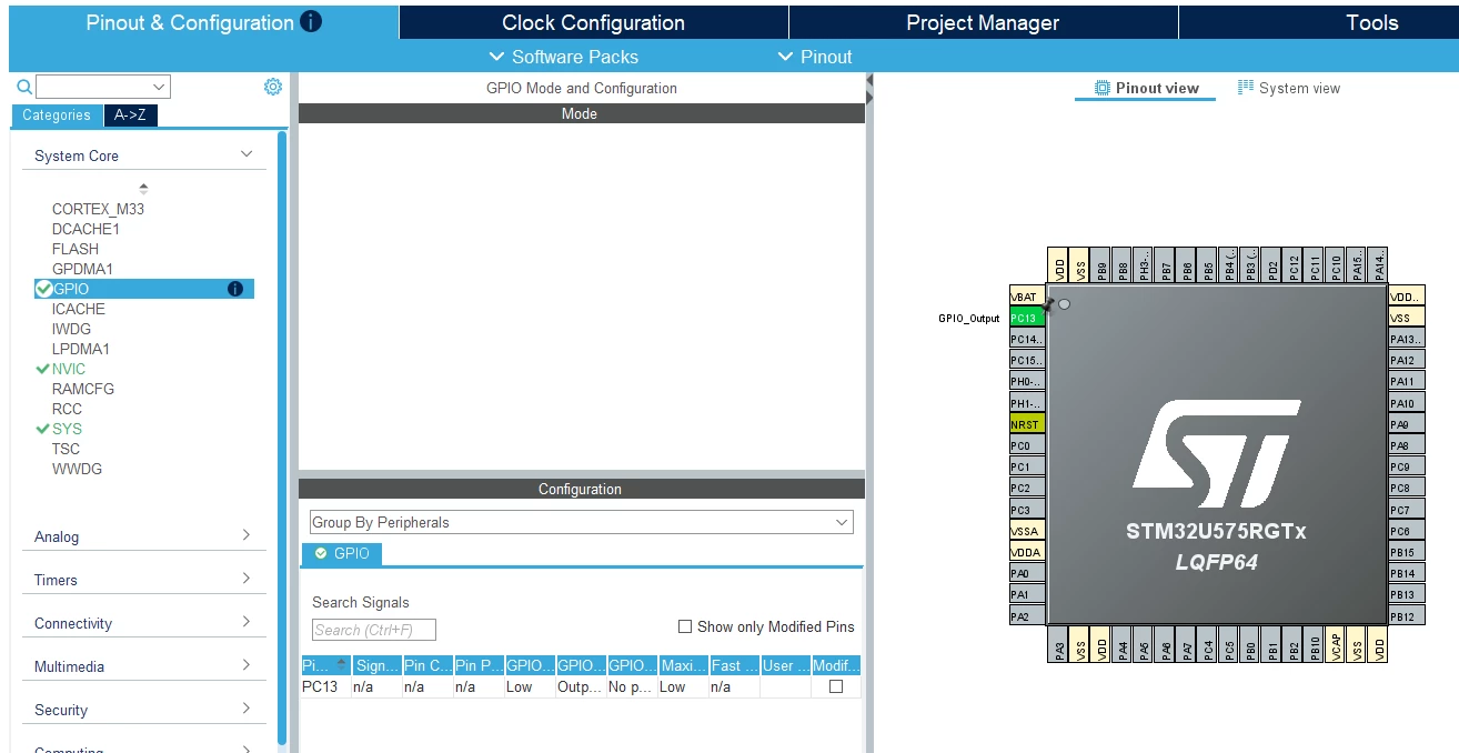

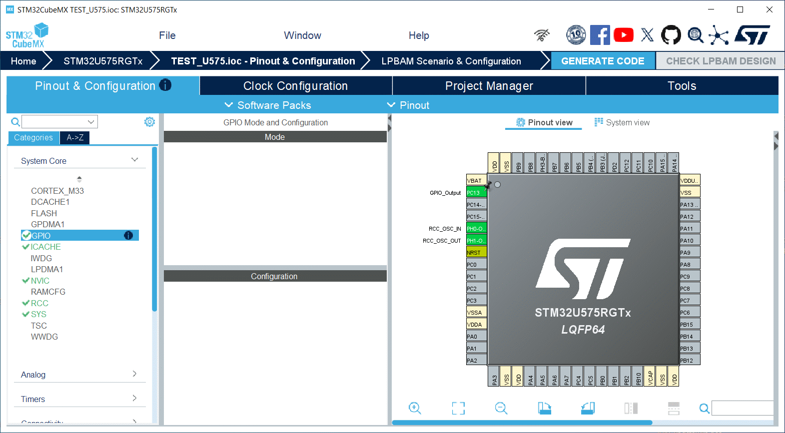

In CubeMX 6.17.0, when configuring GPIO pins, nothing appears in the GPIO window:

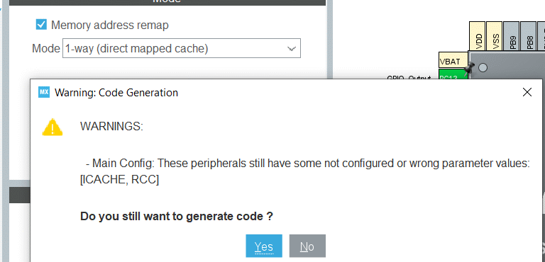

Additionally, there are problems with ICACHE:
I cannot generate code without warnings.
These problems occur when creating the project.
Closing the IOC file and CubeMX, then reopening the IOC file a second time, resolves the issue. I can live with this workaround, but I’m reporting it.

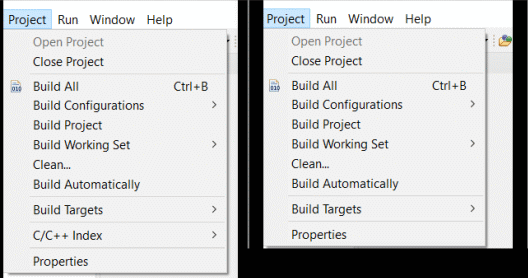

The second problem is in CubeIDE: when importing a project, the “C/C++ Index” tab is missing:

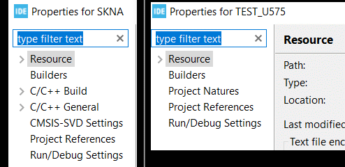

Also some tabs missing in Properties:

I’ve created a fresh project with CubeMx 6.17.0 with the part number STM32U575RGT, configured the pin PC13 on the pinout view and was able to see the GPIO shown in the middle.
Need to share your ioc file to reproduce the behavior.
For the CubeIDE behavior please open a separated thread for that specific topic. CubeMx and CubeIDE are two different things that need to be handled separately.

At this moment, I also unable to reproduce this issue.
Maybe it was triggered by unique sequence of my configuration (because I also configured crystal generator, PLL  and ICACHE).
If I come across it again, I'll let you know.
