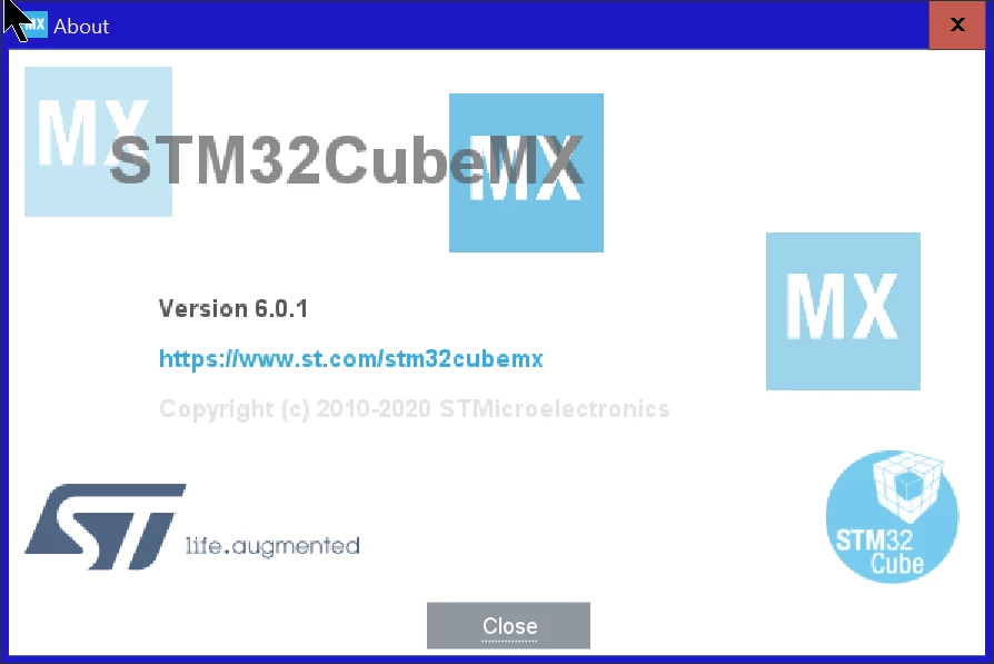

Cannot create Keil uVision 5.27 Project with CubeMX 6.0.1
Hi

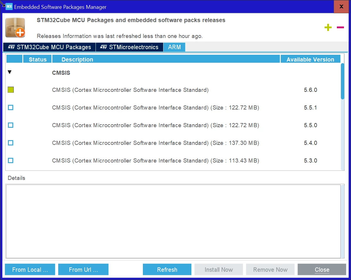

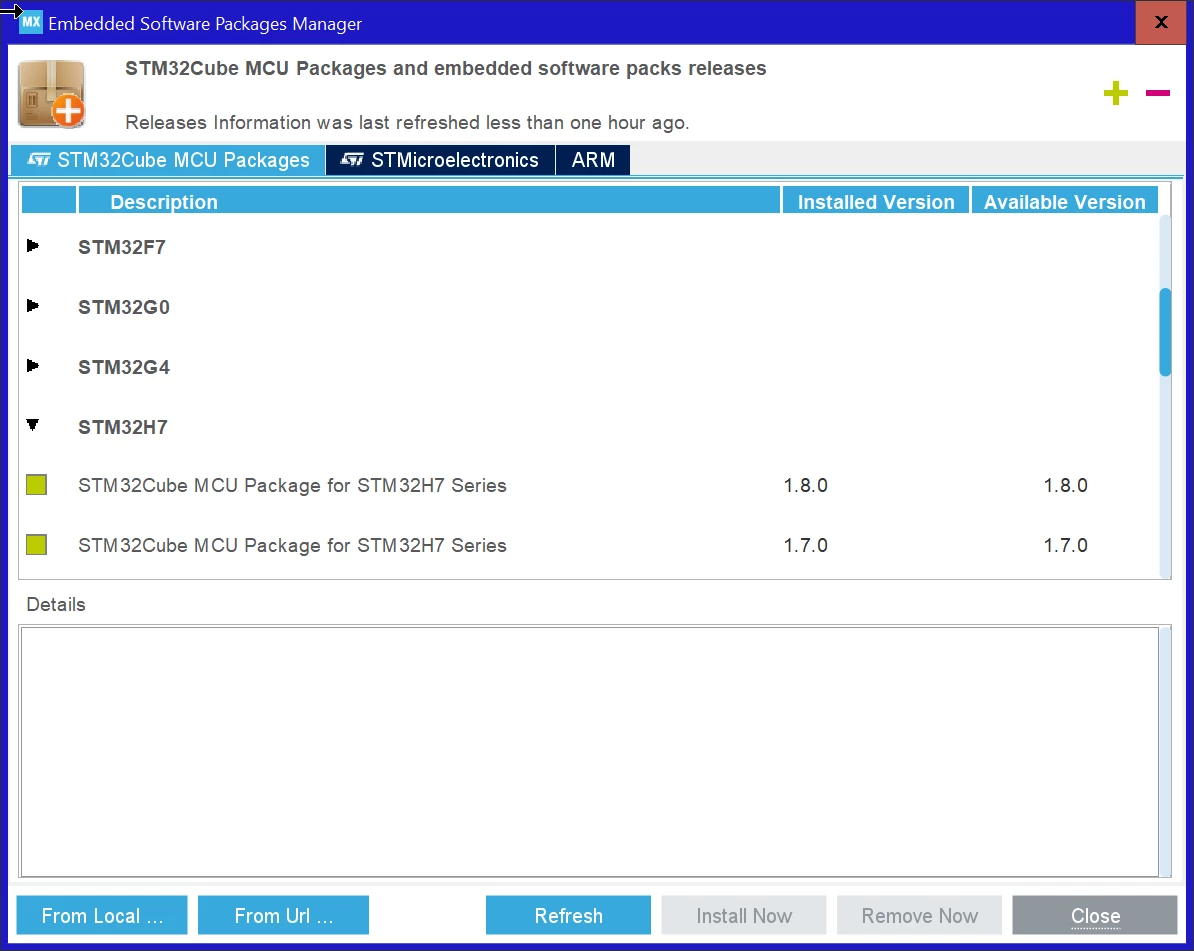

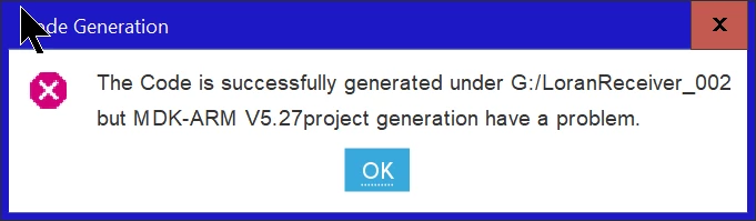

After updating to CubeMx 6.0.1 and my STM32H7 Pack to 1.8.0 I cannot create project code for Keil uVision 5.27.

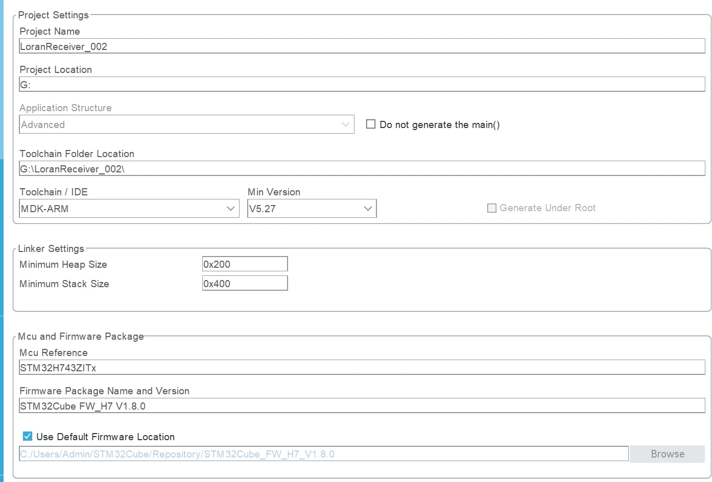

After pushing the create code button it brings up the progress bar, seems to be doing stuff and then brings up a dialog:
"The code is successfully generated under G:/LoranReceiver_002 but MDK-ARM V5.27 project generation have problem."

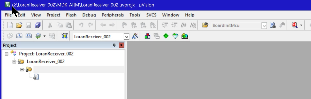

When I open uVision I get an error:
"Error: Device not found -
Device: '??device??'
Vendor 'STMicroelectronics'
Please update your device selection."
The uVision file tree is empty of files and when you open the uVision config dialog no device is selected.

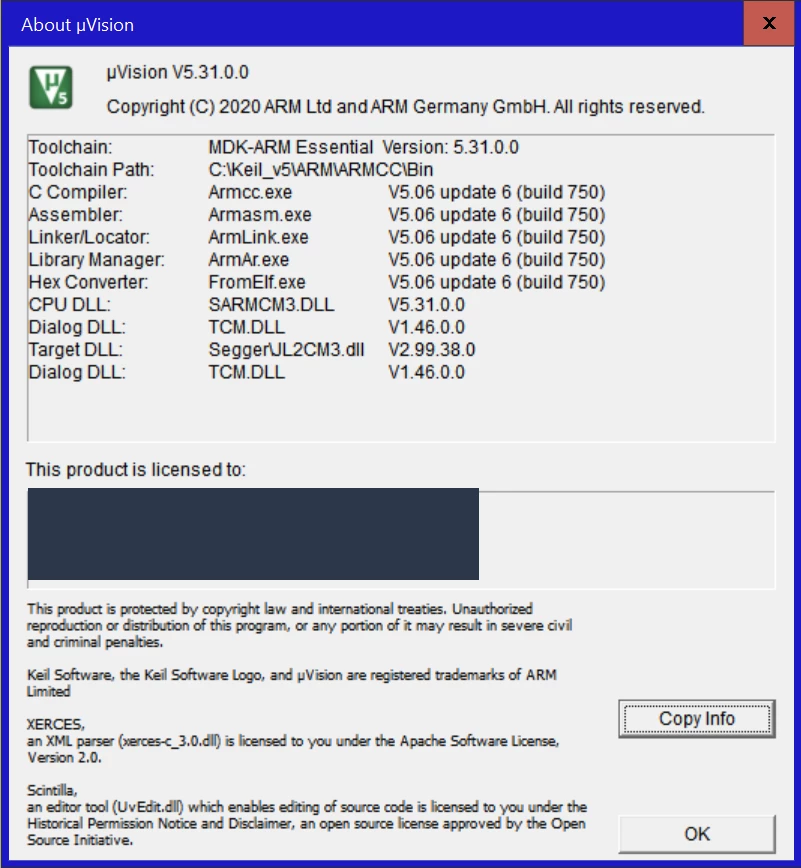

I have not made any changes to uVision 5 since I used it successfully with older versions of CubeMX.
All my MCU packages are up to date in uVision.
I tried ti with an STM32H743ZIT and an STM32F411RE and had the same problem with each.

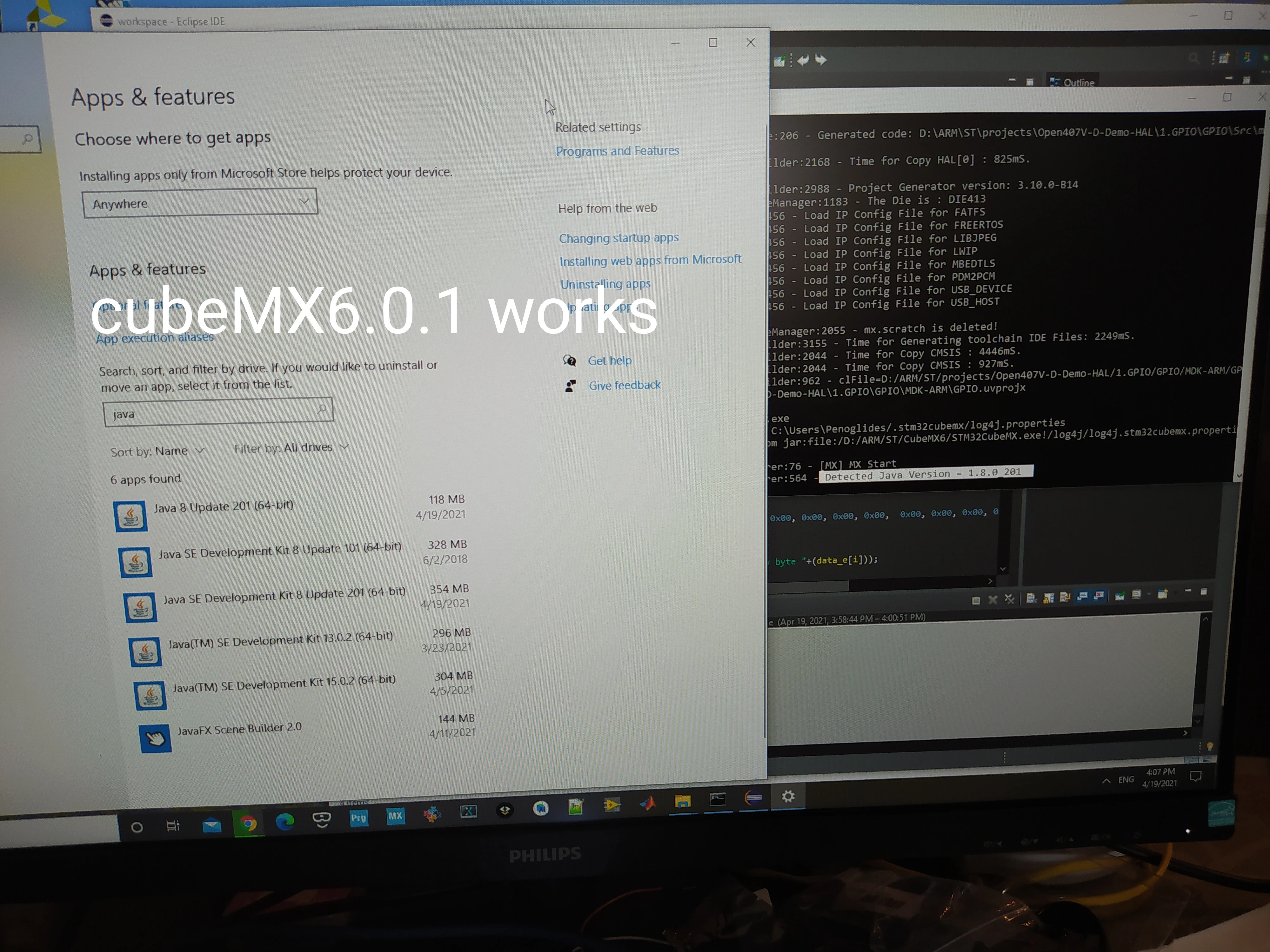

CPeno
Visitor II
Apr 19, 2021 1:40 PM UTC
It also happened to me because I have many java versions installed on my Windows 10 pc. I found a workaround by executing cubeMX from command prompt as java -jar cubeMX.exe. See attachments. When I choose java version 1.8.0_201 from command prompt it creates all MDK-ARM projects correctly. When I run cubeMX 6.0.1 from icon it fails to create MDK project.
