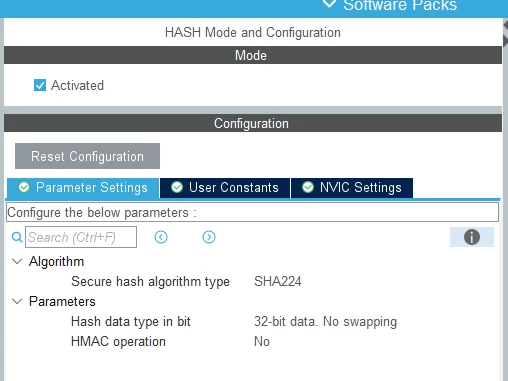

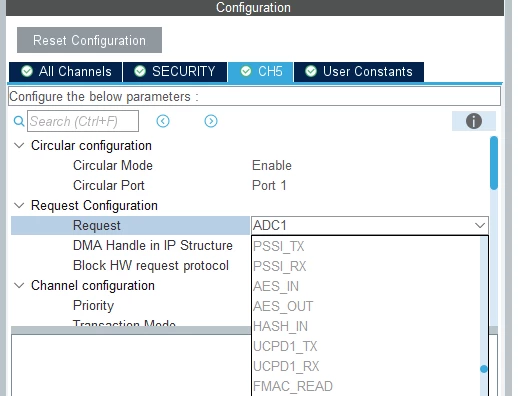

Hello, I'm using STM32H503RBT and trying to configure a DMA transfer from memory to the HASH engine, but even though I have that peripheral configured as show on the picture below, I can't assign it as the request source for the DMA is grayed out and when I hover my mouse over it a pop-up appear's saying "IP has to be configured". I tried creating a second project with the same MCU and had the same problem, although interestingly that's not a problem on the CBT variant (48 instead of 64 pin package). Is this a bug or am I doing something wrong? I'm using version 1.17.0 on Windows.

Hello @QuickSilver127 @and welcome to the ST Community.
I’ve been able to reproduce this behavior on my side and I've escalated internally for correction (under internal ticket number 201722). Thank you for reporting this.
PS: this has been solved on the version 6.15.0 of the STM32CubeMX.
