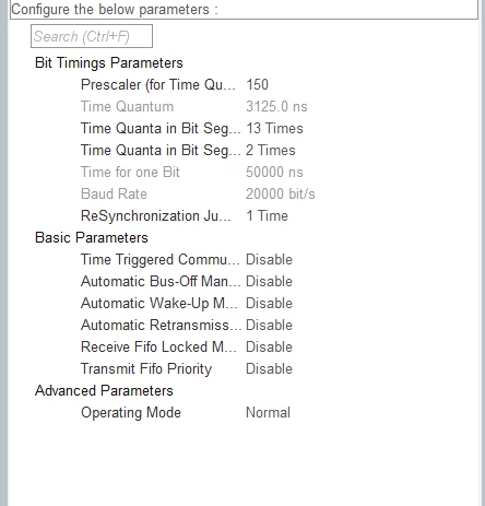

Heres my CAN configuration settings:

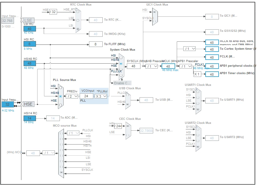

Heres my clock settings:
Any help would be gretaly appreciated as I thought the extrenal clocks should be much more accurate however I can only get my CAN to work using the internal clock sources.

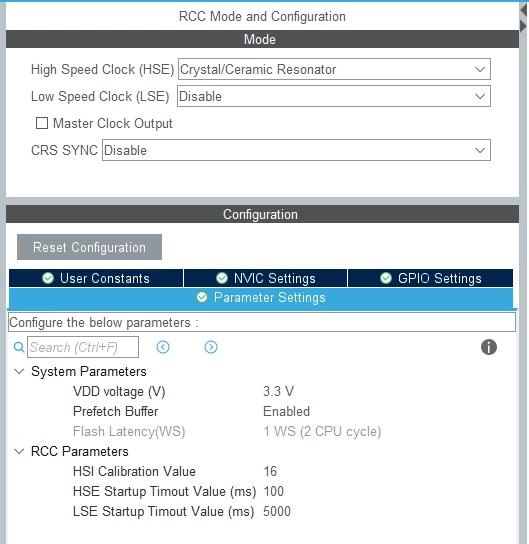

Is this what you mean?
also fro reference my oscillator pins:
RCC_OSC_IN: PF0
RCC_OSC_OUT: PF1
Thanks!

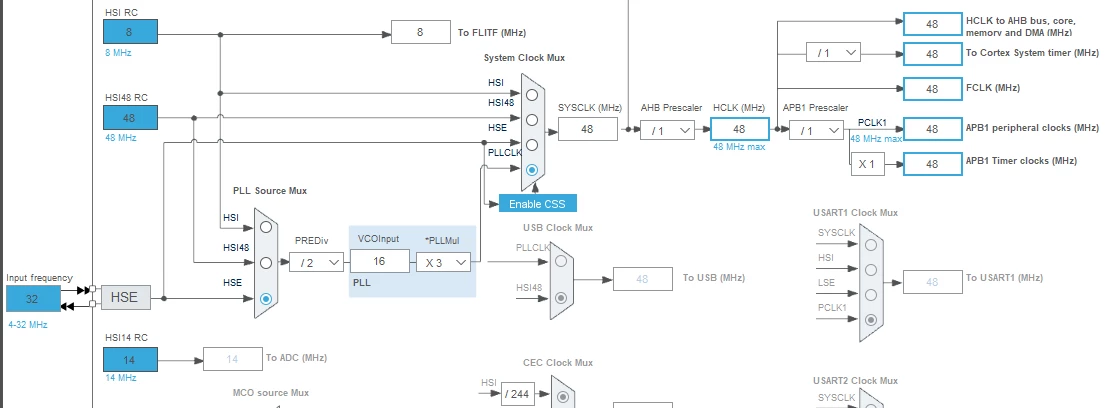

December 5, 2023
I tested like this and it still didnt work?

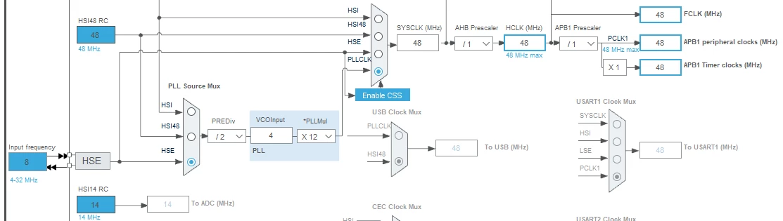

Hi guys thankyou for the help, @Tesla DeLorean you was right! I assumed the deafult configuration for the nucleo board would be set to match the on board crystal which was 8MHz (the default value was 32MHz). changing the input frequency for HSE as per the diagram below:
my CAN comms began to work, thankyou very much for the help guys, Im still learning about all this embedded stuff so I appreciate the time!
