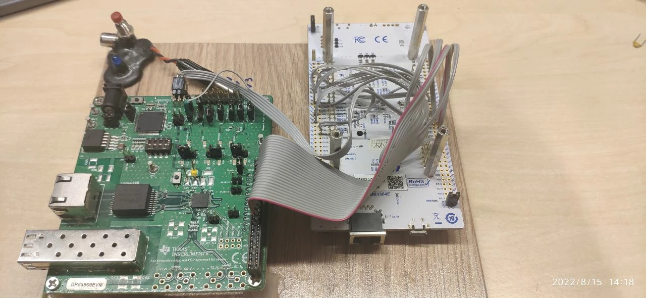

Can't ping H743ii + dp83869. CubeIDE 1.9.0, CubeMX, HAL, noOS, MII, LwIP. But on devbords Nucleo_h745zi2 + PD83869EVM code works fine.
Get a problem with ETH on H7 family.
On my dev-board-stand-with-ugly-wired-beard (pic.1) Nucleo_h743zi2+ Dp83869EVM my project works fine.

But when I use custom board with STM32H743II with this project, I cant ping my board.
Pinout almost the same.
For now i find out - MCU don't generate any signals on Tx0-Tx3 pins, but Rx0-Rx3 pins work well.
Any ideas?
