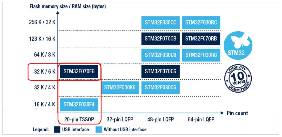

It looks like there is an STM32F070F6 in TSSOP-20:
https://www.st.com/en/microcontrollers-microprocessors/stm32f0x0-value-line.html
Have you tried the Product Selector?
https://www.st.com/en/microcontrollers-microprocessors/stm32f0x0-value-line/products.html

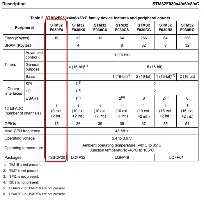

Are you sure that part number actually exisits?
https://www.st.com/resource/en/datasheet/stm32f030f4.pdf#page=88

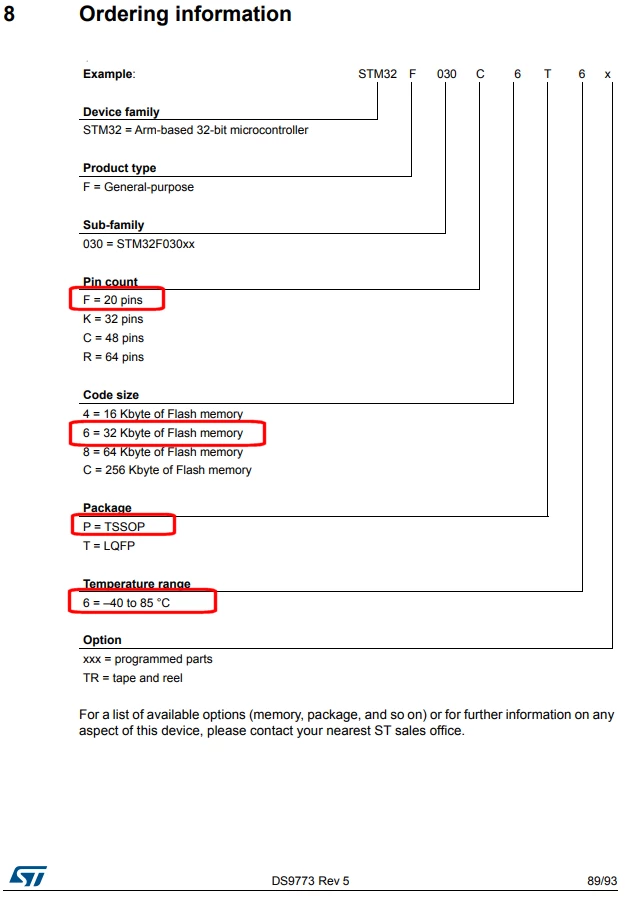

So STM32F030F6P6 would be in a TSSOP-20 package.
But the only option listed in TSSOP-20 is an STM32F030F4:

The statement from @Andrew Neil is completely correct: even if you can piece together your preferred order number from the data sheet, that does not mean it is a deliverable device.
Specifically, there is currently no STM32F030F6P6. If you have a very large requirement, you are welcome to check with your local distributor whether this larger flash variant would be feasible in the TSSOP20.
