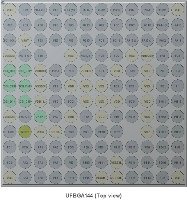

We are using MIPI-DSI on a STM32U5G9NJ.
First bug: There are 2 pins missing in the Pinout View: D4 and J9. Both are VDD11 pins.
Second bug:
After Enabling LTDC and DSI in STM32CubeMX I can't select "Active High" for "Data Enable Polarity" in LTDC -> Parameter settings.

I'm sorry, after writing some of the text I changed the package without double-checking that both bugs are present in this one.
The faulty package is exactly the UFBGA-144, therefore the STM32U5G9ZJ.
Take a look:
Sep 11, 2024 2:27 PM UTC
Hello @upCntx ,
Further to your comment, I can confirm that there is a mismatch between STM32CubeMX and DSI14102.
Thank you for bringing this issue to our attention, it has been reported internally to Dev team for correction (under internal ticket number 190802).
Thanks.
Mahmoud
