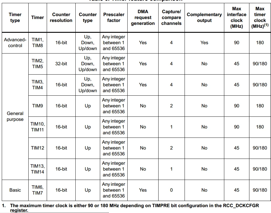

Hi, I've got this from the F446 data sheet.
I hope that I can run TIM2 at 180Mhz

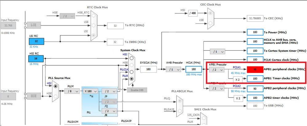

However, it seems that APB1 peripheral CLK can only run at 90Mhz as the cubeMX indicates as followed:
So can I really make TIM2 run at 180MHz or not?!

As you can see in that clock tree above, all TIMx timers have a clock separate from their respective APB clock. The APB clock still determines the access to their registers through the respective APB bus, but their internal clock input runs from that separate clock. Electrically, all TIMx timers are capable of running their internal clock input at 180MHz, see datasheet chapter 6.3.19  TIM timer characteristics.
The APB clocks can't run as high as the AHB clock i.e. at 180MHz, they have to be divided. If that divider is 2 and RCC_DCKCFGR.TIMPRE = 0, the timer clock is 2x APB clock, i.e. equal to AHB clock. If the divider is 1, 2 or 4 and RCC_DCKCFGR.TIMPRE = 1, the timer clock is equal to AHB clock.
However, the maximum clock for APB1 is 45MHz, i.e. if AHB clock is 180MHz, APB1 divider must be at least 4.
