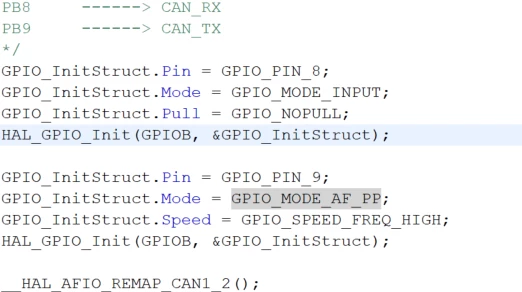

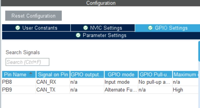

I have stm32 bluepilll on which I am able to transmit CAN messages but CAN Receive interrupt is not generating.
I found while configuring that CAN RX pin(GPIO mode) is getting configured as Input mode. How accurate is this?
I  think it should be Alternate function. I made PB8 as Alternate function still CAN Rx interrupt is not working.
Above statements are under stm32f1xx_hal_msp.c

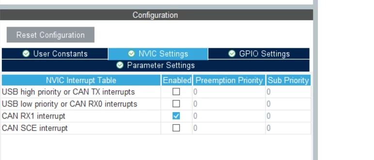

I am using CAN RX1 interrupt, following are  my configurations

Hello, i have the same configuration Suryaprakash2002. CAN RX does not trigger also for me. I do not know what to do. CAN TX transmit well, CAN RX does not trigger. The scope shows the recieved CAN at the CAN_RX PA8 PIN. What i noticed is that after a can message received the CAN TX pin PA9 goes for some bits(2 or 3) low and then high again.
Any ideas?
Best regards
Jannaros
October 17, 2023
CAN RX1 interrupt it does not work. You do not have to change the filters.
I found an alternative solution for not triggering the interrupt:
At CubeMX go at Connectivity->CAN->Configuration->NVIC->
 -USB low priority or CAN RX0 interrupt  (activate)
 -CAN RX1 interrupt  (deactivate)
Then the CAN communications works well.
