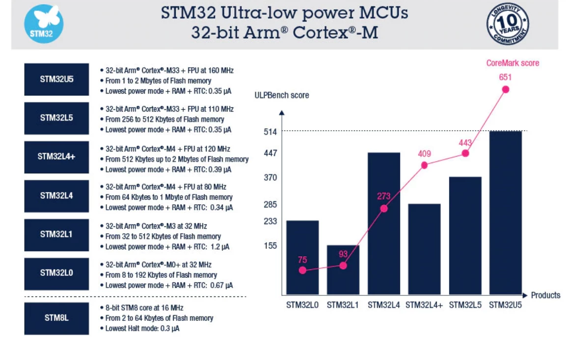

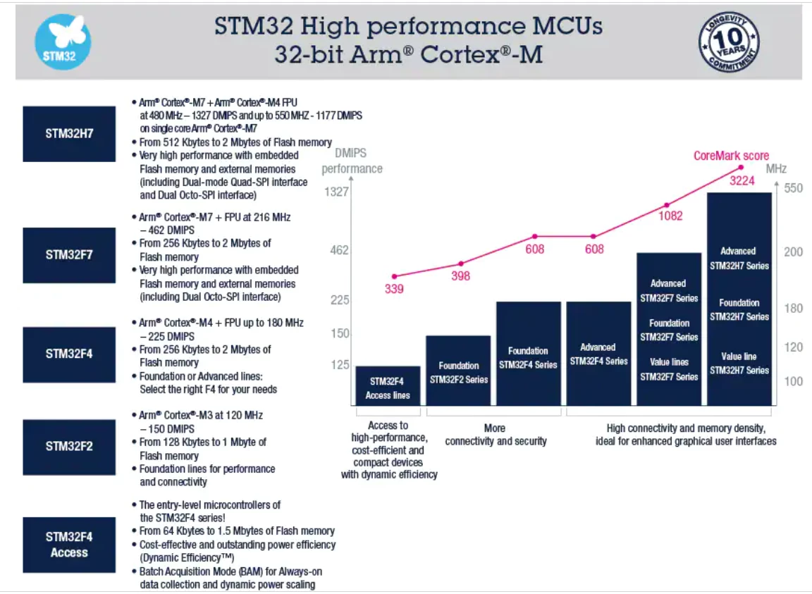

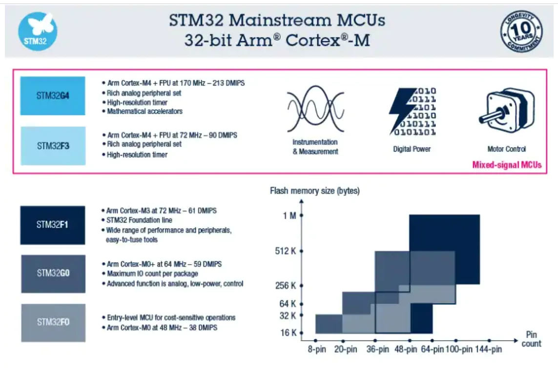

Can I find a place with a table that shows all the MCU compare including: CPU, memory ?

Hello @msror.1​ and welcome to the community,
Maybe these graphs can help you
