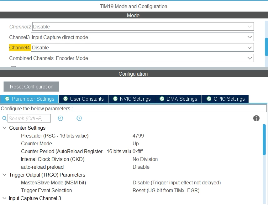

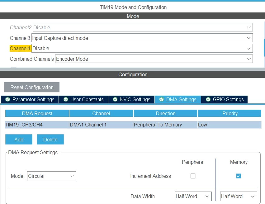

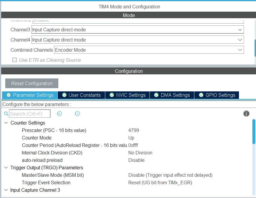

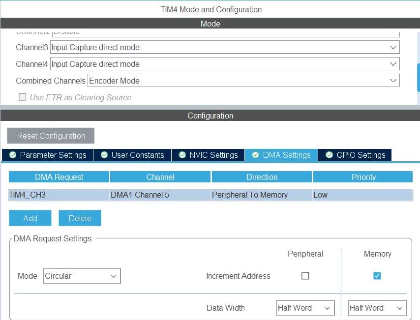

Can I combine Encoder with Input Capture at DMA?
Hi!
I have a STM32F373 processor and I have 2 Encoders and 3 Input Captures.
I have enabled DMA for input capture.
Timer 4:
0693W00000D1n2KQAR.png0693W00000D1n2PQAR.pngTimer 19:
And I have this code.
My questions are:
  1. Can I use Encoder together with Input Capture if Input Capture has DMA?
  2. What will DMA store inside the arrays input_capture[2]? Is it the counter value? I'm assuming it will be some kind of a counted value, right?
  3. Will this work?

Yes.
IC will capture the CNT value at the time of the event, which is then transferred by DMA.
